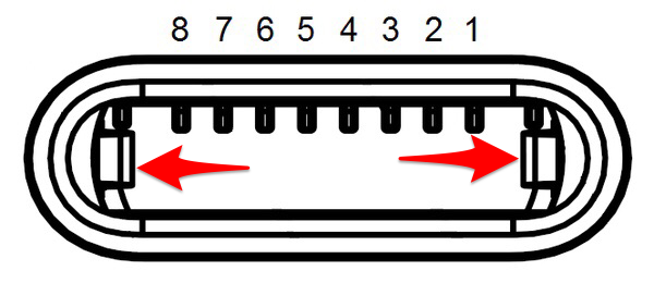

It's hard to see deep inside the port. I found that using a strong magnifying glass and bright flashlight beaming down into it allowed me to see what was really going on inside the port (broken side retaining spring)
So what would be the best way to clean the lightning port without damaging the connection springs?
Please explain.
Thanks
On each side of the Lightning port there is a spring tab that holds the plug in place. You can feel them when inserting the plug and it clicks into place. On each side of the Lightning plug there is a small divot. The spring tabs grab those and lock the plug in place.
If one of the spring tabs inside the port gets busted, the spring tab on the other side pushes the plug slightly sideways, misaligning the pins and since there isn't an opposing force (from the now broken tab) the plug fits loosely inside the port - and doesn't make a secure connection to the pins.
A wooded toothpick is fine to clean dust out. Just be careful.

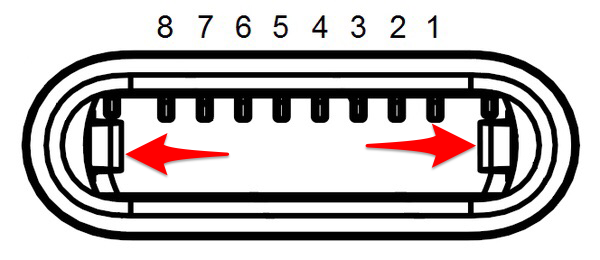

Thanks for that, didn’t realise those tabs are spring driven.
