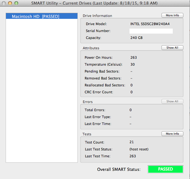

Shot in the dark, but have you tried downloading SMART Utility? This'll check the SMART data on the HDD. If it comes out with anything other than 'Passed', it's a corrupted HDD. It'll only take a few minutes to download and run so it's worth a quick check.
Please quote this to let me know the news either way, and we'll run some more diagnostics if that comes out clean.
Thanks for the suggestion. Got the passed
