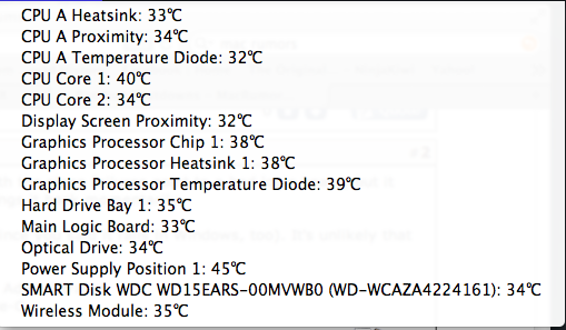

sounds like the cpu is overheating and thus getting a mandatory shutdown.. next time it does it, leave it off to cool for a bit and then see if it restarts normally... that would point to a overheating cpu.. also have you run the hardware check cd??
always handy when you have issues. 🙂
lol just saw that your temps are normal, what are they btw?? still run the hardware check cd though 🙂
Temps
Here i have uploaded the pic of the temps, i don't think thats the issue. It's running pretty cool. I just took the whole iMac apart just to check for imploded capacitors, and the ones on the power supply look fine... I basically pushed made sure the wires to the supply were tight. I didn't take the board out because it seemed like it would be a pain. I'm definitely inclined enough to do such things, i just don't want to have to resort to that yet. As of right now i'm on the iMac and it's running ok, but who knows it might shutdown again. I've read other forums where people replaced the power supply and fixed the issue. they described the same issues i'm having. When the computer shuts down it restarts right after. Maybe tightening the connections might have helped but who knows. It's tricky.. maybe it's the power supply but not a cap thats bad.

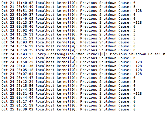

Next time it's up, check through /var/log/system.log for the previous shutdown causes. Generally, anything zero or above is normal, and anything negative is probably not (though -60 is a battery dying, and -128 means it doesn't know).
Yeah for some reason i was under the impression that DiskWarrior had a test diagnostic similar to AHT. I do not have the Disk that came with my iMac so i cannot run AHT. Here i have uploaded a screen shot of my kernel.log as i searched shutdown. As you can see it shows a few -128 and then some 0. The weird thing is those 0's. I didn't shutdown normal any of those times. Those were all times last night i on the machine and it failed. It even seems like there were more times it's not even showing. I'm really hoping it's the power supply, last night i opened up the machine and checked the power supply. It looked fine and the connections look fine. So obviously i'm going to try the cheapest solution first. but the question i have is... Can a power supply that has no blown capacitors and looks fine still be failing? The shutdowns are so random, and then after having one sometimes the computer has a hard time restarting. It will just sit with a black screen as it tried to turn on, ill hear the fans huff for a second, and the disk drive start up as it usually does for second, then it will do that over and over until it eventually restarts. Or i don't even have to reset the SMC. If i just let it sit for like 10 minutes, it will start up normal. So i was just wondering if i should order the supply and try that first? As a side not when i type in my machines serial on the Apple site i still have Service and Repair coverage but I'm not sure what gets me. I can't imagine they'd fix it for free.

If it's still under the three-year AppleCare, they'll fix it. If it were only shutting down, I'd go with the internal power/dc/inverter cable. Since you have a hard time starting it back up, it's more likely to be the power supply.
A shutdown code of 5 should be a normal shutdown or sleep, whereas on that machine, a 0 means power was disconnected. -128 shows up whenever it doesn't know, which happens whenever you boot to a different OS or device.
Make sure your power cable is secure, and then suspect power supply.
Alright, i really appreciate the help. I figured it might be the power supply, is there a shutdown code that shows logic board or smc failure? I'm assuming the combination of 0 and -128 shutdowns shows it's the power supply. So yesterday i bought a power supply and it should be in on Friday... Once i get it installed i can test the situation farther. Hopefully it will fix my issue.. It just seems with the codes and the fact the computer shutdown when more things draw power from it, it seems to me that could be the issue.
