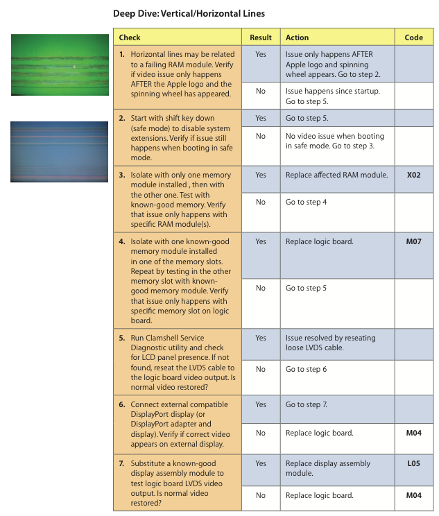

Here's what I have supporting me. First of all, there is no MacBook Pro Late 2010. Someone else in the thread said they have a 13" Mid 2010. I've attached descriptions from the service manual of the two closest symptoms.
I'd like to point out that the limits of software fixes involve PRAM reset, SMC resets, and researching available firmware and software updates, and the recommendation for software updates only comes in to play if external video is fine but internal video is distorted (according to the Apple service manual). Nowhere in any of the Apple documentation does it ever say to wait for Apple to release a software update; That's just bad customer service. Nowhere does it ask if it's specific to the version of OS X that's installed or if it's limited to a small handful of applications. Until it's definitively shown to be fixed with a software update, the solution is not to update the software.
Additionally, it may also be useful to point out that there is a repair extension program for the MacBook Pro (15-inch, Mid 2010) related to graphics issues. It's not these specific issues, but at the very least, it does point out that there are hardware problems with some of these machines. Note that in this case, the recommended update to 10.7.2 means that they're trying to fix a hardware problem with software. If someone is running 10.6 and has this issue, the solution isn't to buy 10.7. The solution is to replace the logic board.
Since someone posted a link to another thread where people had similar issues, I'd like to point out a specific response in that thread. "I had a similar issue. Took mine to Apple and they replaced the logic board and it worked again. So my advice: go to Apple with it."
So, yes, get your three-year-old to pass the certification exam. It truly is dirt easy. Then, your three-year-old will agree that the proper course of action according to Apple is to replace the logic board. So, what evidence do you have supporting the claim that it's software?
