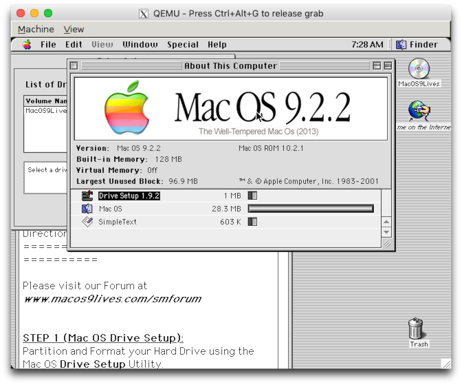

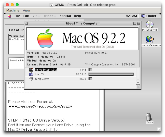

Booting The Mac OS 9.2.2 Universal iso in QEMU (PPC, no KVM)
Code:
pi:~ $qemu-system-ppc -M mac99 -m 128 -cdrom ~/vm/macos922uni.iso -boot d -vnc :5,password -monitor stdio
Pi Time to boot and show the Mac OS 9.2.2 Read Me: 4 minute 01 seconds
Code:
g5:~ $ qemu-system-ppc -M mac99 -m 128 -cdrom ~/vm/macos922uni.iso -boot d
G5 Time to boot and show the Mac OS 9.2.2 Read Me: 1 minute 27 seconds

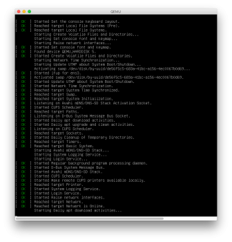

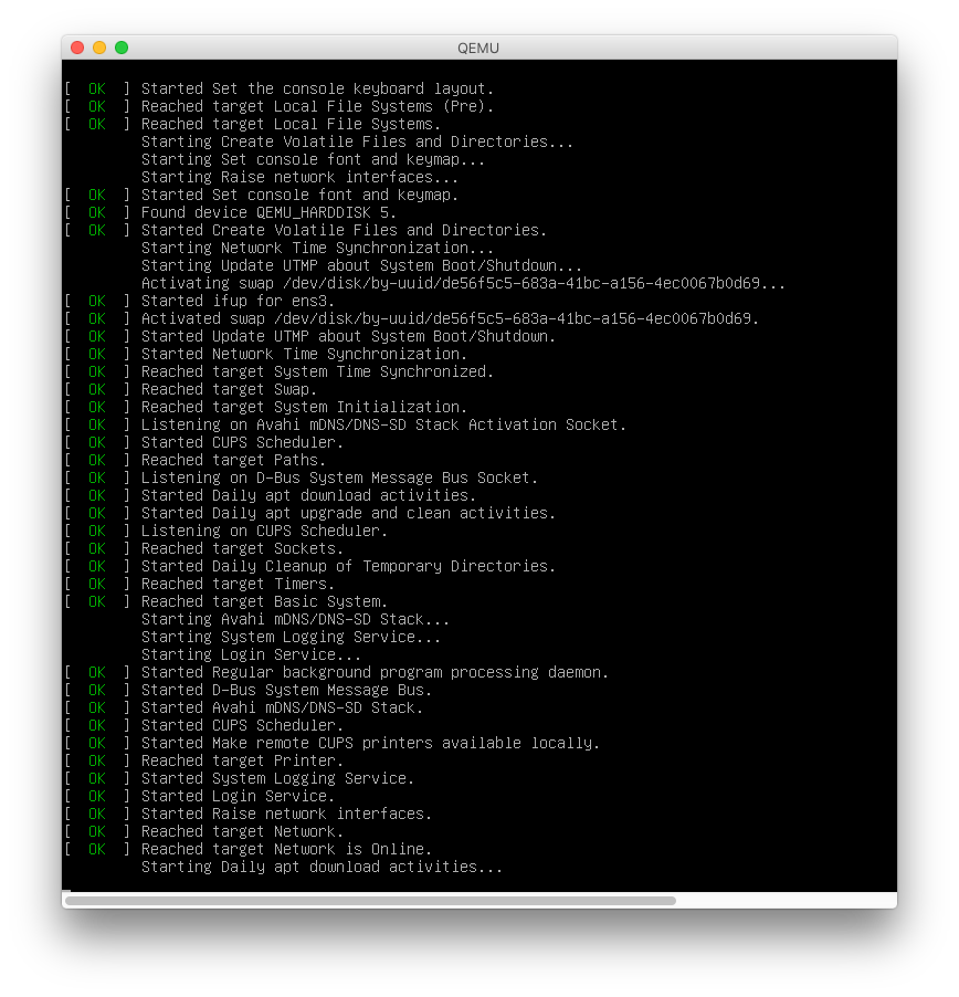

Booting Debian 9 x86_64 img in QEMU (x86_64, no KVM) [With thanks to @Lastic]
Code:
pi:~ $ qemu-system-x86_64 -smp cpus=4 -boot c -hda vm/debian9_x64.img -m 512 -net nic -net user -vnc :5,password -monitor stdio
Pi Time to boot to user login prompt (no GUI): N/A (I gave up after 13 minutes of zero progress)
Code:
g5:~ $ qemu-system-x86_64 -smp cpus=2 -boot c -hda vm/debian9_x64.img -m 512 -net nic -net user -vnc :5,password -monitor stdio
G5 Time to boot to user login prompt (no GUI): 3 minutes 52 seconds

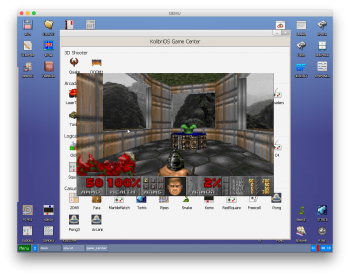

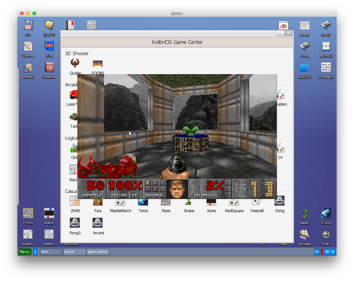

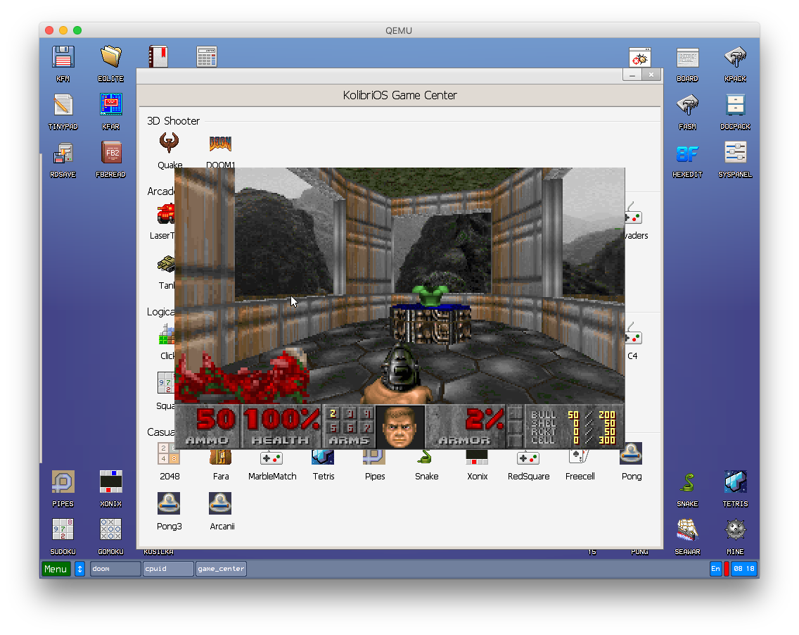

Booting KolibriOS in QEMU (i386, no KVM)
Code:
pi:~ $ qemu-system-i386 -m 256 -cdrom kolibri.iso -boot d -vnc :5,password -monitor stdio
Pi Boot to Desktop: ~11 seconds
Code:
g5:~ $ qemu-system-i386 -m 256 -cdrom kolibri.iso -boot d -vnc :5,password -monitor stdio
G5 Boot to Desktop: ~6 seconds
Both machines could run a smooth game of Doom in an emulated x86 system delivering graphics over VNC, running KolbriOS (the Pi is running over wifi, the G5 is on gigabit).
