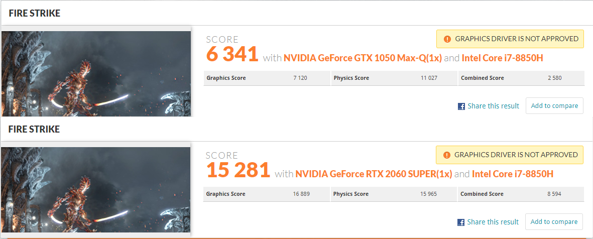

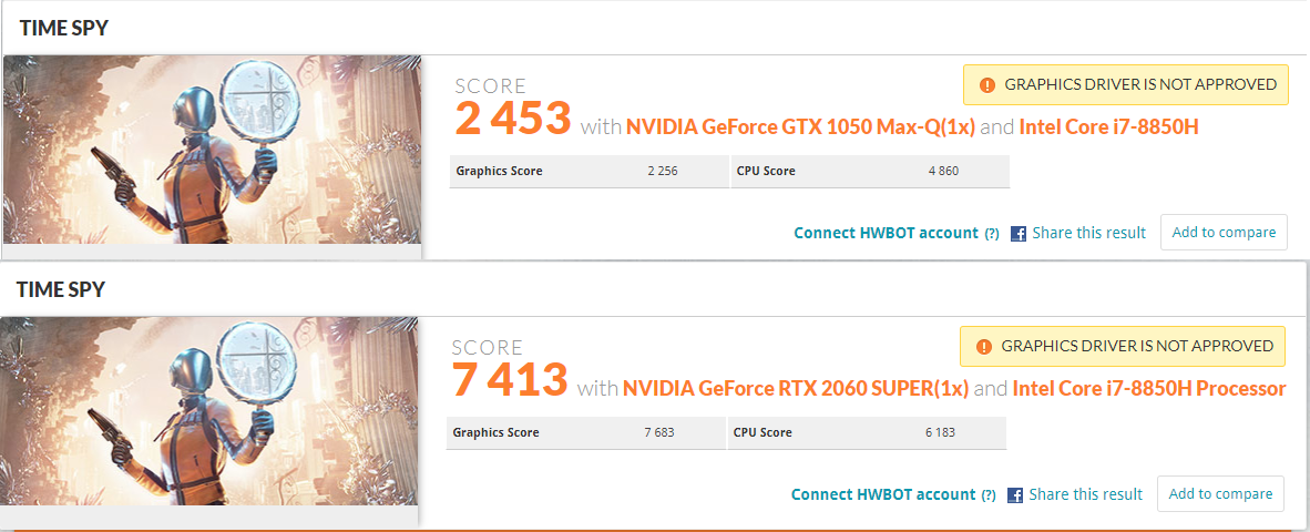

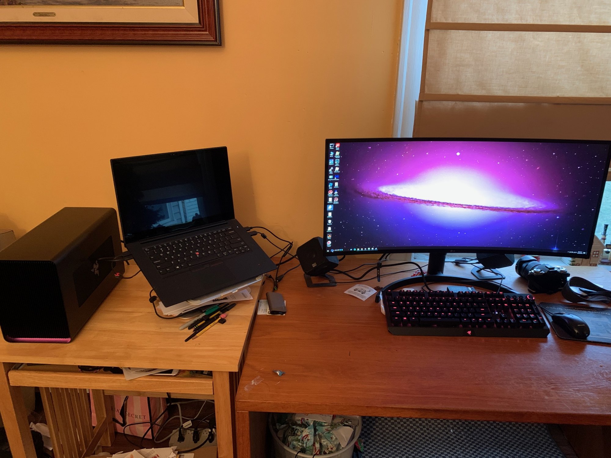

So I bought csurfr's Core X Chroma and that arrived yesterday, I also picked up an MSI RTX 2060 Super. I opted for the mid range model which provides better cooling so the fans don't need to run during normal non-game playing tasks. Additionally, I determined that the 2060 model was a better buy, as the 100 - 200 price increase on the 2070 wasn't worth it, as I'll only see about 10 - 15% performance boost.
Overall, the Core X is freaking huge, I don't think the picture really expresses the size, but it's virtually silent, again thanks to the mid range card I picked.
The performance is really impressive as shown below.
I haven't played any games yet, I'll do that later today but overall I'm really happy with the setup
That 2060 Super score is significantly better than what I got with my Lenovo Yoga and AMD RX 5700 XT. The Yoga CPU was bottle-necking me more more than I realized.
What about the PSU and chassis fan noise? It was really loud on Core X (without chroma), at idle. I replaced the PSU with Corsair SF750 (fan off until 300W) and used Noctua for chassis.
Your CPU scores are a lot better with eGPU. Is Lenovo throttling the CPU when gtx1050 is active?
PSU fan is near silent, and the GPU fans aren't spinning when I'm doing mundane stuff, like working. Maybe they're using different fans for the chroma version. @csurfr could maybe confirm if this was quiet/noisy for him when he owned it
Yeah, it might have been - odd. I didn't notice ¯\_(ツ)_/¯
