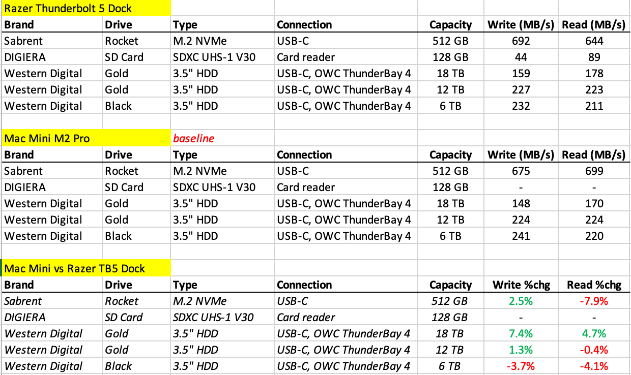

Got one of these in the Mercury (silver) finish for free on Amazon Vine recently. Instead of flipping it, I might replace my more purpose-built Satechi dock for something a little more future-proof… granted it doesn’t act as a space heater when in use. Will report back.
Update with results below (Blackmagic Disk Speed Test used, and either OEM or Cable Matters TB4+ certified USB-C cables):
In summary, with a Mac Mini I'd rather use the more aesthetically pleasing Satechi dock, and I only have one 4K LG monitor in use. If you have a MacBook (Pro), and more than one display, you may well find this very useful, but otherwise it's a bit overpriced for what it is. Speed increases are negligible if any, as far as I can tell.
Some may prefer the Razer for its more powerful TB5 ports, and 3 more than let's say the Satechi dock, which won't even connect the OWC Thunderbay enclosure via its USB-C port. That's another advantage the Razer has, but whether it's worth the extra cost is up to you.
Any indication from your initial usage on how hot it gets (if you're using the storage?) and how loud the fan may be?
Didn’t have an NVMe lying around, unfortunately, but with a lot of crap attached it only got mildly warm to the touch. And I don’t believe there’s a fan in it, just airflow channels.
