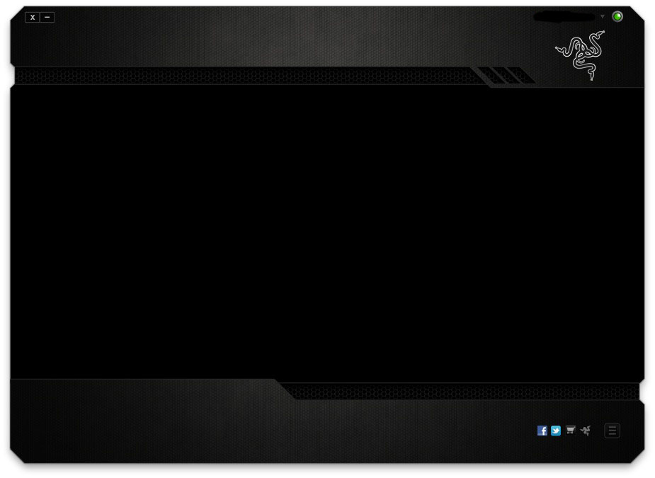

This is the new window:
I'm having similar problems. I just got a Naga yesterday. It was working fine last night, but this evening Synapse stopped recognising the mouse. Just getting a black screen and no mouse settings. I've also tried uninstalling and reinstalling to no avail.

When I take my air on the go, I usually unplug everything and head out. When I come back and plug the mouse back in, I usually get issues. Rather a blank screen, I can't even open the window at all and my mouse is not recognized by the software. What I have to do is actually kill all the razer processes in the activity monitor and let the thing turn itself back on, or turn it on from my apps folder. Usually that fixes the problem.

Are you using the latest Razer Synapse 2.0 Mac Driver? The last update I saw in their website was February 8, 2012. You can also update the software using the glowing green button at the bottom-right side of its window (see kamuix screenshot).
