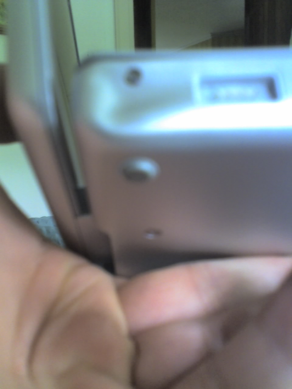

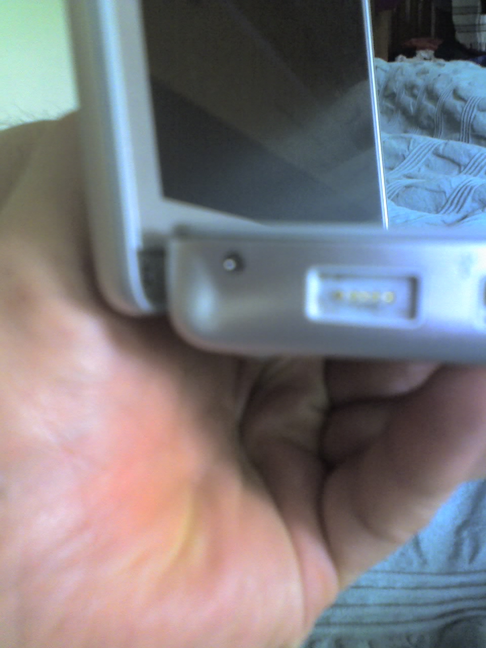

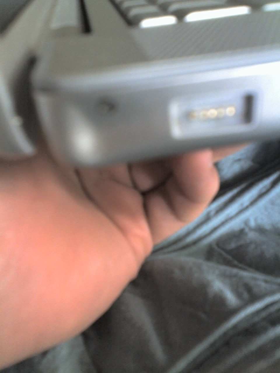

Here are some pics about the strange dent that I feel could be attributed to the heat. Unless someone else dropped my computer (but I know I didn't)... even if, its a strange place for a dent, and I have dropped powerbooks before...
What do you guys think? (sorry about the quality its off my cell phone)
That's an impact or manufacturing defect dent.
