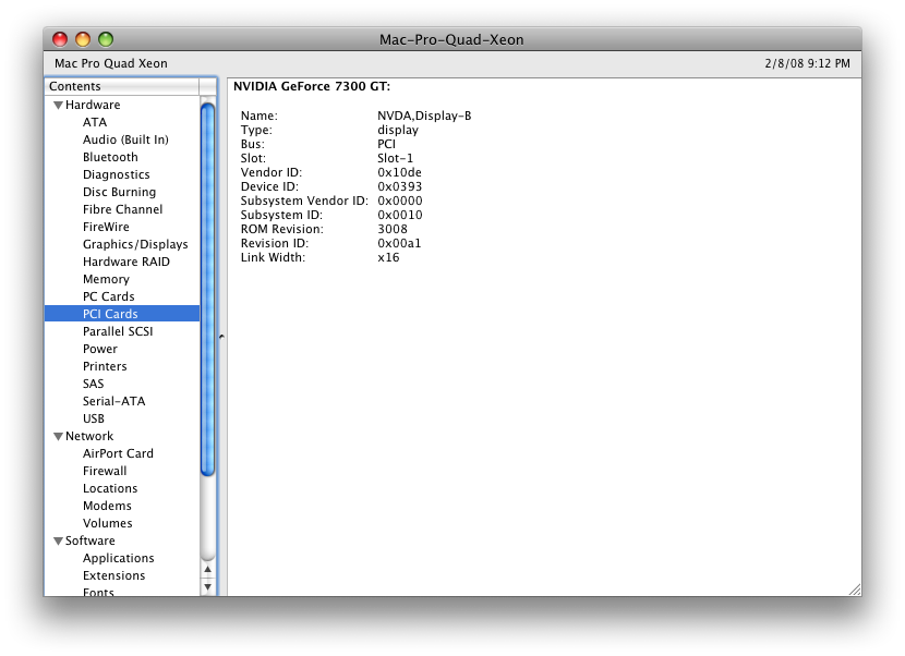

EDIT: Actually, I might be wrong. Either way, your computer will have all the drivers necessary. How do you know it doesn't see it? Check System Profiler to be sure. It will be listed here, along with your original video card, if it is recognized:

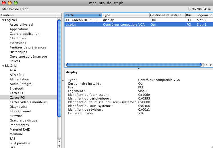

well my computer see the card, but this one don't work.
I don't have the drivers i think
Won't work.
You can't make the GeForce 7300 GT work on the new Mac Pro "2008." It's not like you can install a driver in Mac OS X. It lacks the 64-bit EFI code in the card's firmware.
