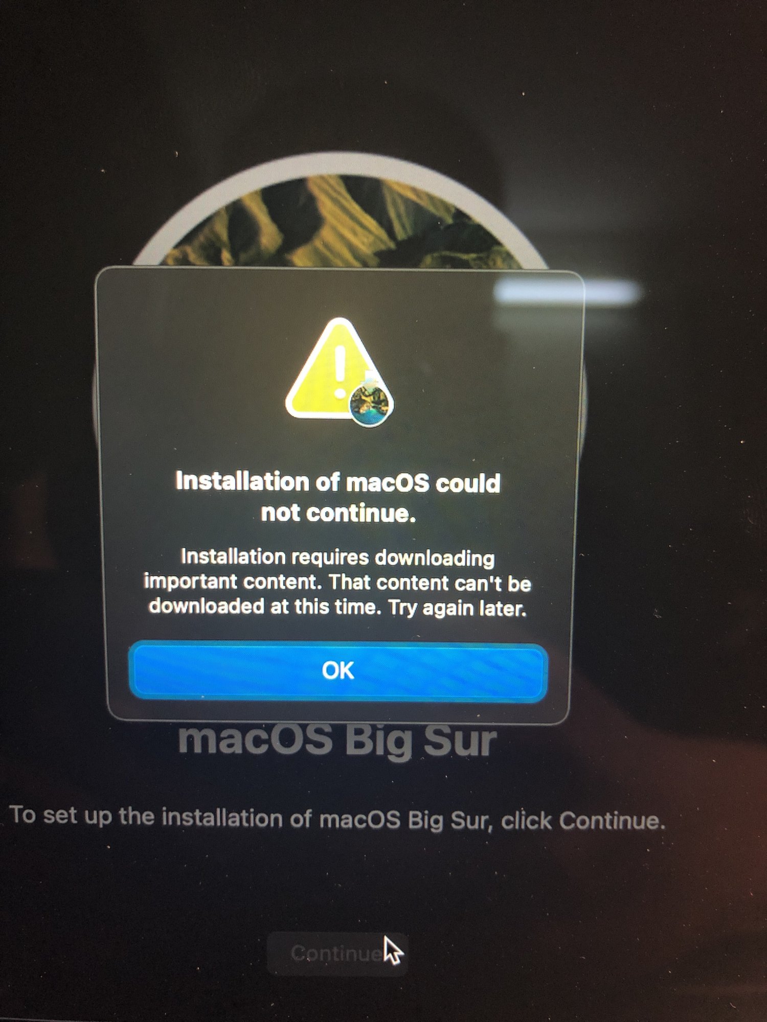

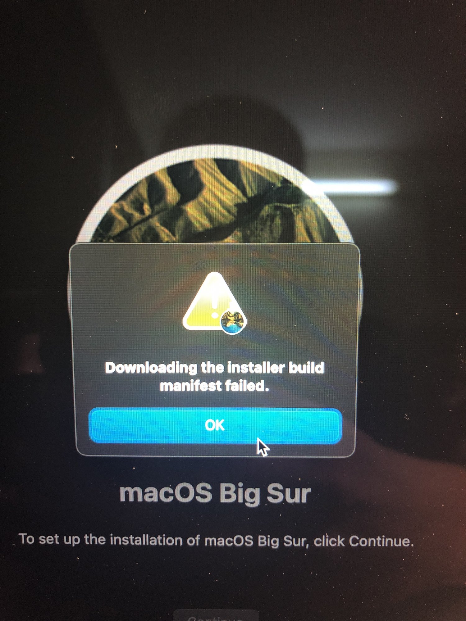

I have got a second hand M1 MBA, I'm spending almost 3 hours already trying to install Big Sur from the recovery assistant. Terminal install does not work, re-install Big Sur gets me stuck at the create computer account screen, and I do not have a second Mac to run the Mac configurator.

Finally managed to install after rounds of trial and errors, playing with Terminal, and pressing re-install again. Took almost 3 hours. Its a second hand relative new M1 Mac 🙂, that's why the previous owner had to wipe it. I don't remember Macs being this complex to manage a re-install of the OS..
I just did a clean install on my M1 Air last night and was surprised by how smooth it was. What issues are you having exactly? Can you post an image?

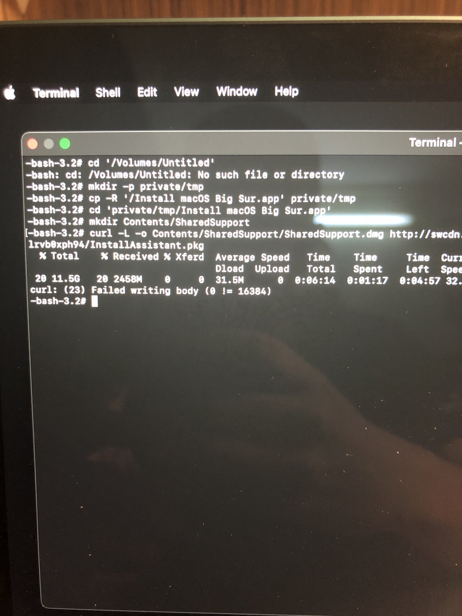

I kept getting fail to write in Terminal, then the Mac getting stucked at the Create Computer Account page, now seems to be resolved after 3 hours of playing in Recovery mode and following all the steps on Apple support page.
Here are some of the images I got before I successfully installed. Took me the whole night to resolve these issues. This is really unlike Apple where everything just works in the past ?

I can see why you weren't getting anywhere. You didn't use quotation signs for your Terminal operations.. the first line Failed because you didn't need quotation signs there - I can only see a single ´
Code:
cd /Volumes/Untitled
You should use quotes for when you have a path with spaces in them unless you put in '\' as the space indicator
Of course now that you have it all resolved I will take a step back and just say congratulations 🎉
It shouldn't be this hard to install macOS - and it isn't, if the user just uses the various Terminal commands correctly 😀 (as a general rule and not a put down on you specifically. I mention this for myself also)
