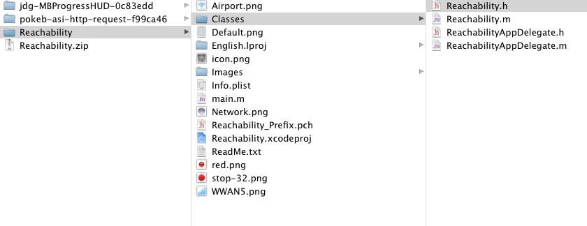

The last part is to test to see if an internet connection exists. So I downloaded the Reachability class from the Apple sample code.
In the sample Apple provided there are a lot of items (photo included). After looking at everything I see the only thing I need to import in to my project are the,
Reachability.h
Reachability.m
and instantiate an object from that Class. I don't think I need the the ReachabilityAppDelegate.h or .m and those are used for the demo project?
Thanks.

There is probably some code in ReachabilityAppDelegate that you'll want to incorporate into your own appDelegate.

I just implemented this into a project this week. It's easy to work around the ARC issue.
1. Click on the target.
2. Choose the Build Phases tab.
3. Reveal the Compile Sources by clicking on the triangle.
4. Double click the Reachability.m file.
5. In the pop up edit box, enter -fno-obj-arc and click Done.
While you have that panel showing.
1. Click the plus sign under the Link Binary With Libraries.
2. In the drop down panel, type the first few letters of System.
3. Select SystemConfiguration.framework
4. Click Add.
In the Reachability.h file add the following line to get rid of some warnings.
#import <netinet/in.h>
I've setup an ivar in my app delegate and make calls to that. I've also setup the notification so that I could have a little red light / green light icon that tells me when the connection is on or off.
That's good to know. So what it is doing is adding a 'Flag' of some kind to the Reachability class that tells the compiler to treat just this one class differently?
Thanks.
Yes. Also the Analyzer accounts for it too from what I see. OH, and the editor.
