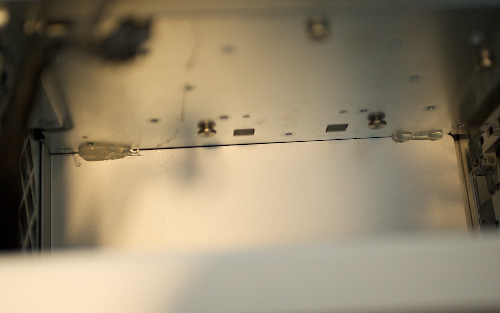

I had the exact same buzzing noise. It's always been random. I think the noise is generated by an aluminum bracket that's behind the optical sled. The bracket is secured by two screws on the top, and has two tabs that slide into notches in the bottom. I believe the panel's tabs are vibrating in the slots, causing a kind of Sympathetic resonance. My solution was to use a simple glue gun and place small dabs of hot glue where the tabs insert into the slots, and coving the two screws on the top (just a dab will do ya). This will dampen the resonance between the bracket and the case. So far I've had the MP running about 15 minutes and NO noise yet. I'll post a follow up later today with more results..
-Dougie B

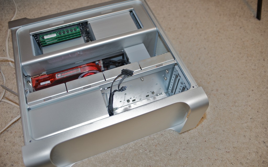

I made Pictures.
Over 4 hours and still no vibrations!
http://www.flickr.com/photos/10550957@N05/sets/72157622253552309/
I used to have a buzzing sound when the superdrive spun at high speed (very very loud). Just touching the sled would stop the vibration. So I just jiggled it around a bit and haven't had the problem since. Just seems like if the sled is in the precisely wrong position it will vibrate against the rest of the case.
Thanks for the pics. 🙂 At least I know the problem isn't anything serious. I am not that handy so probably won't put use the glue solution. I am afraid I get it all over the place.

ribbon cable
The ribbon cable is there, well maybe not a ribbon per-se
http://farm3.static.flickr.com/2611/3922728633_780342723a_o.jpg
This is the Sata cable that attaches to the optical drive(s).
Someone thought this cable was rubbing against the fan, but in the 2009 Mac Pro there is a fan guard that would prevent the fan making contact with the sata cable.
If you don't want to use hot glue, perhaps try some kind my moulding putty, as long as it can withstand heat. Anything will work that fills the gap between two metal surfaces and dampens vibrations.
-dougie
