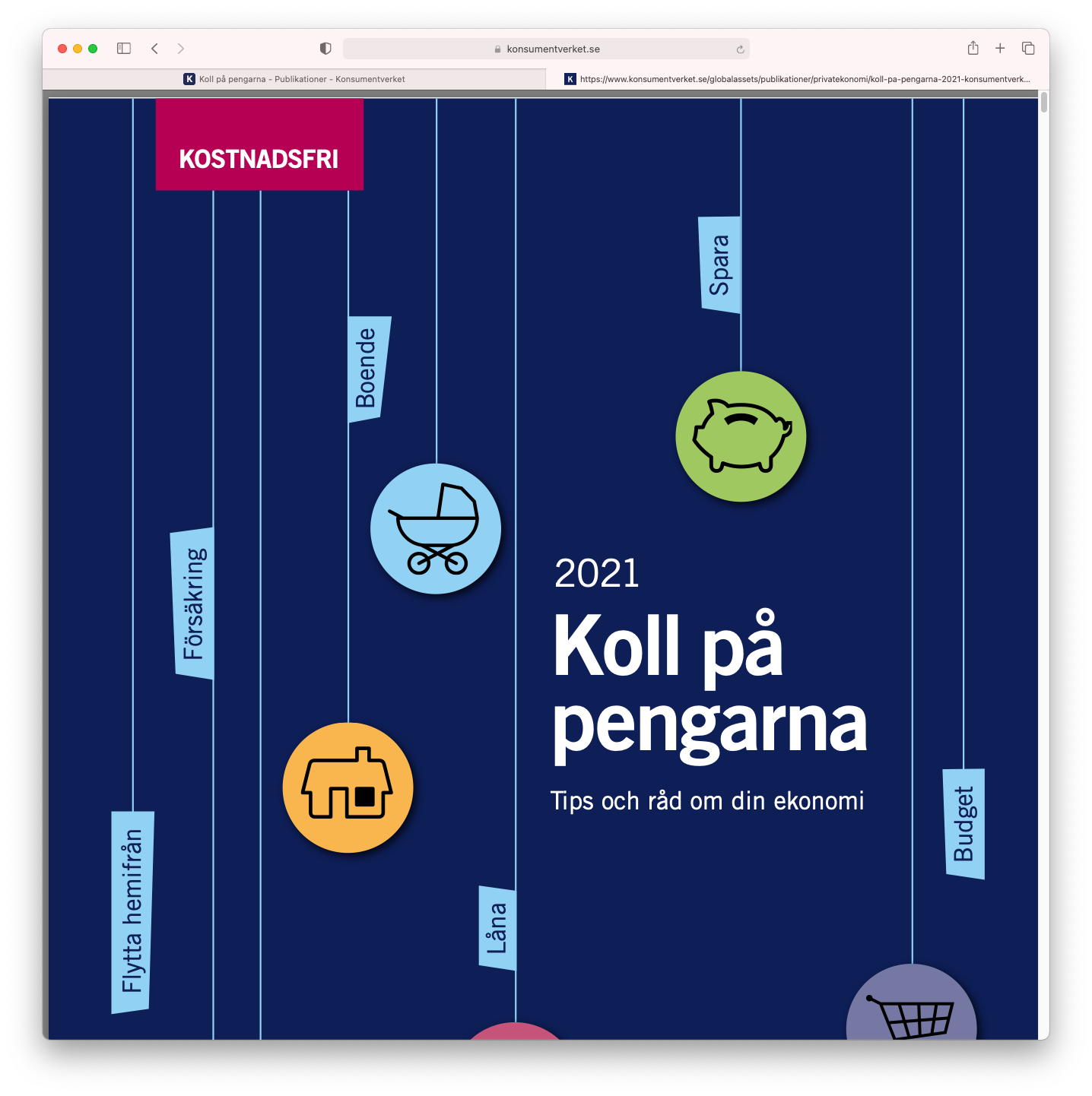

When I press that button on my other user that I have on the same Mac (a user that is mostly untouched, most for testing purposes) I see this (ie, the PDF is shown in Safari):
When I press the download button on my regular user (where I have stuff since 100 years ago, at least 😉 ) a new tab opens, and the file is downloaded to my Desktop (since I have set that location as a download folder in Safari Preferences (And Yes – I have also tried to set it at the default location (ie Downloads), to no avail)). Nothing more happens. I have to open it manually (unless I delete my entire Preference folder, I still haven't found which file regulates this).
Which means: I get a new empty tab, and the file is on the desktop. Hurray! 😒

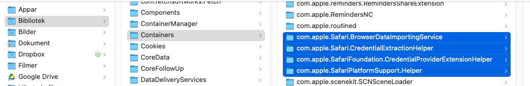

Thanks Kallt, but I don't have any com.apple.Safari.plist file in the Containers folder. I have a couple of folders, and deleteting them didn't help either.
I have already deleted the .plist file in the Library/Preferences folder (a couple of times), to no avail.

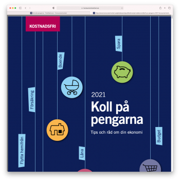

Finally, I do see the PDF's in Safari instead of having them downloaded... 🥳

...I eventually had a complete Container > com.apple.Safari folder that I couldn't move back without getting the error. Thus, you were correct @KALLT ! I must have missed something when I removed the Container folder before, I'm really not sure.
