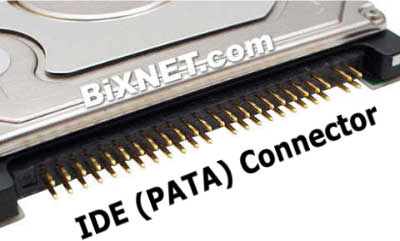

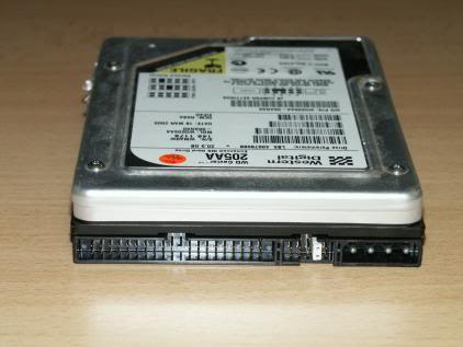

Actually, ATA is another term for IDE. I saw 2 different results when searching that drive, one is IDE and one is SATA.
This is a laptop IDE connector
This is a desktop IDE connector
This is a SATA connector (doesn't matter if it's desktop or laptop.
