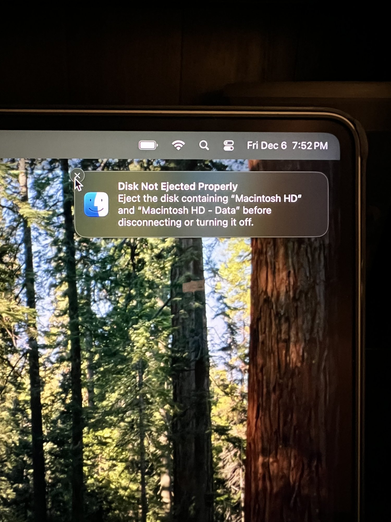

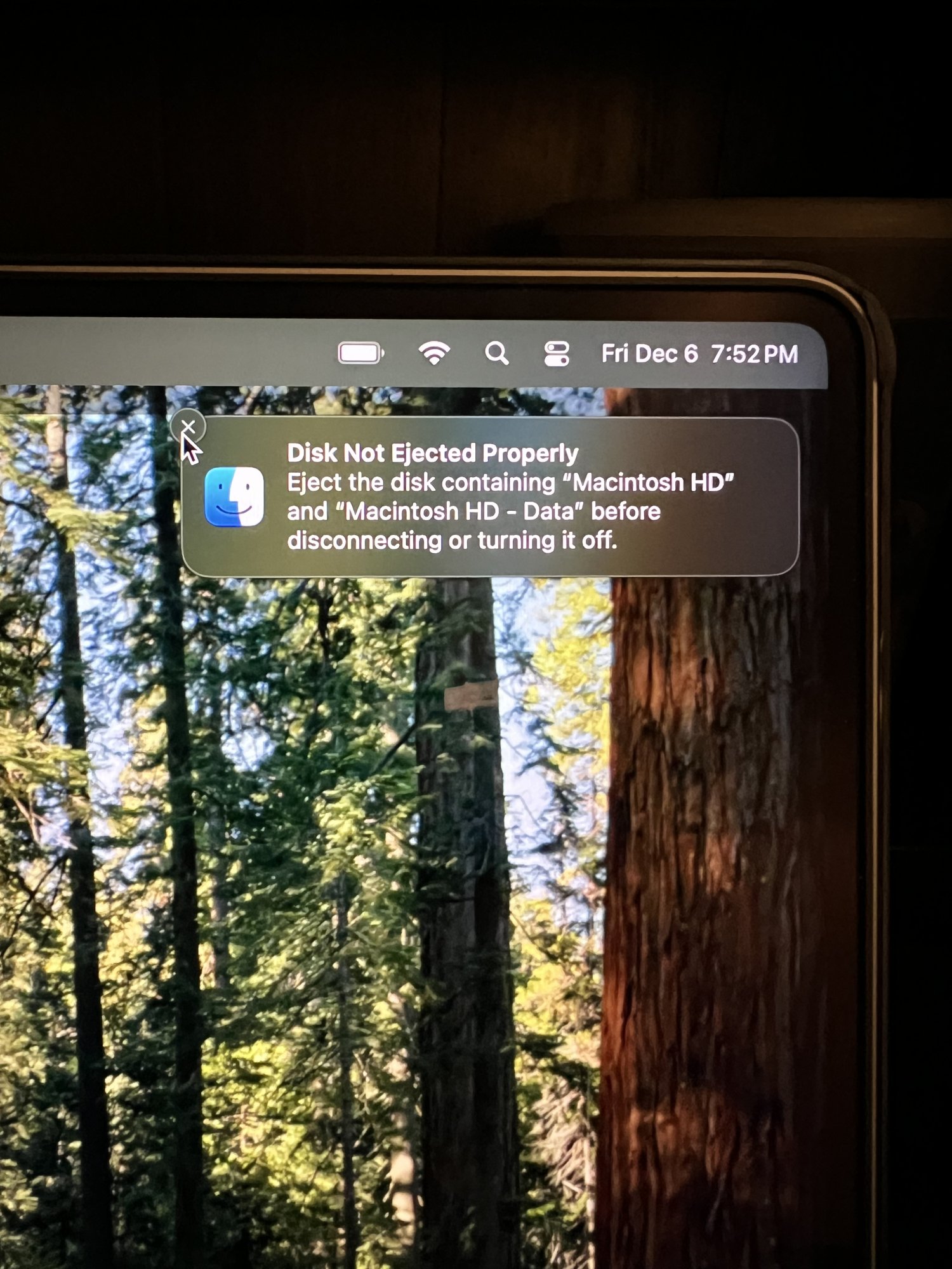

Hello All, I have an old SSD removed from a MacBook Pro model A1398 that I used to own. I put it in an external enclosure and connected it to my newer 2021 M1 MacBook Pro and I am trying to access the photos and files that are still on it. I am getting a message "Disk Not Ejected Properly" when trying to read it. Any ideas about how to get past this?
Thanks

Try a different USB cable to connect from the external enclosure.
Or, a different enclosure.
Or, connect to a different Mac
The MacBook Pro was a 2015, is that correct?
If so, these use a blade SSD with a "proprietary" connector.
What KIND of external enclosure did you use?
I don't believe a standard "M2" or "nvme" enclosure will work, because the pinouts are different.
We need to know that information before going further.
I believe Other World Computing makes a special enclosure for these SSDs, but it's expensive.
There may be a few other 3rd-party enclosures available.
