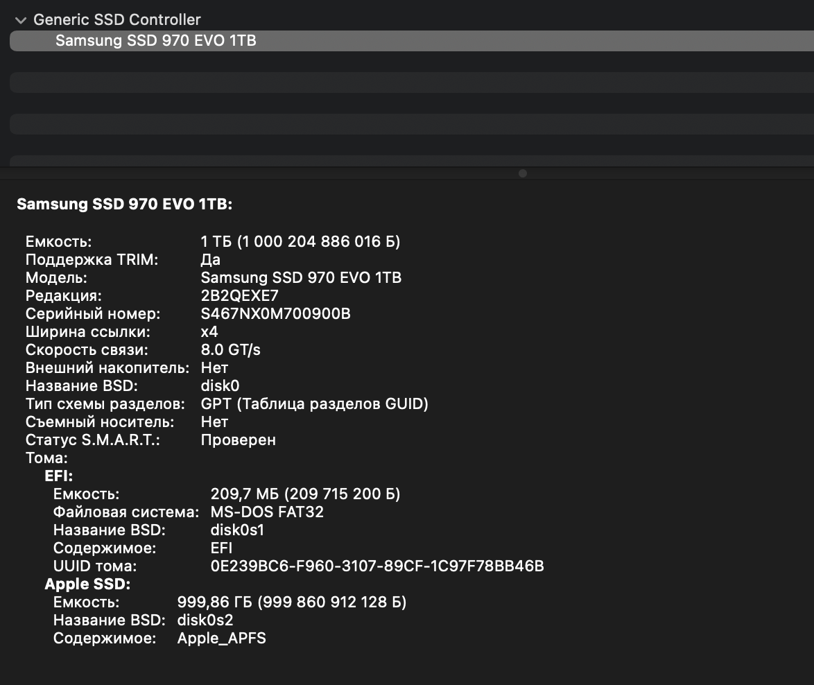

Good afternoon. Tell me please. Imac 2019 5K. Samsung 970 EVO 1TB SSD disk. Such a disk was supplied from the factory or it was opened and installed?
Have you ever installed a Samsung ssd?

I had an iMac 27" late 2015, which had that Samsung 970 EVO 1TB SSD installed by an Apple technician (Norway). A lot better than the spinning HD 👍
Reactions: oxidia
Original SSD would show up as "Apple SSD SM0128L" or something similar.
Someone replaced the original drive with a 970 EVO using an adapter.
Reactions: oxidia

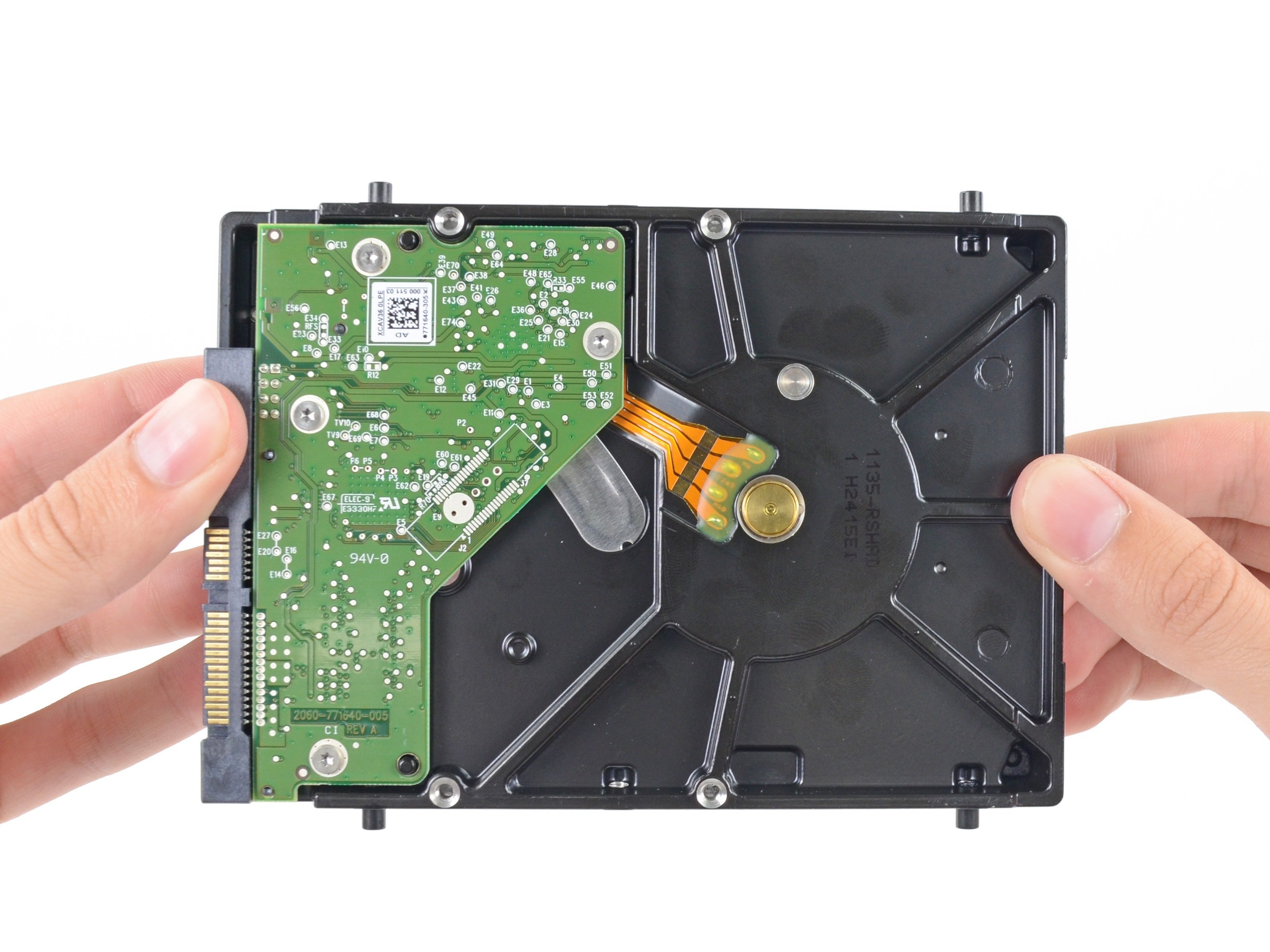

Are you guys saying that the only SSDs Apple installed in the 2019 iMac is the blade SSD?
iFixIt clearly show it had a Fusion drive. The blade SSD and a hard disk.
Yes, the only SSD installed in the 2019 Apple iMac is the Apple's blade (nVME) SSD.
No SATA 2.5" SSD with Apple brand.

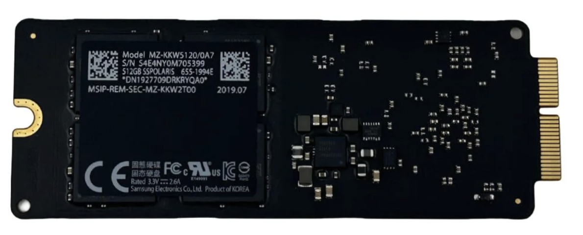

I guess the only SSD Apple factory option was blade SSDs, like on the photo.
655-1994E, MZ-KKW5120
SATA SSD like your Samsung 970 EVO, has been installed later

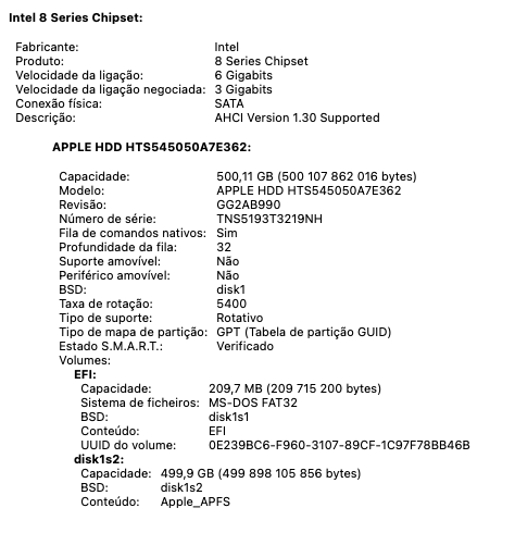

Look at this video. Then you will understand why the upgraded Samsung you have is better than original HD (Hard Disk) from Apple.
The blade and the HD is working together. Apple calls this Fusion Drive.
The blade SSDs are much more expensive than the HD, and fast. The HD is slow, but cheap.
The SATA SSD you have is faster than the original factory HD.

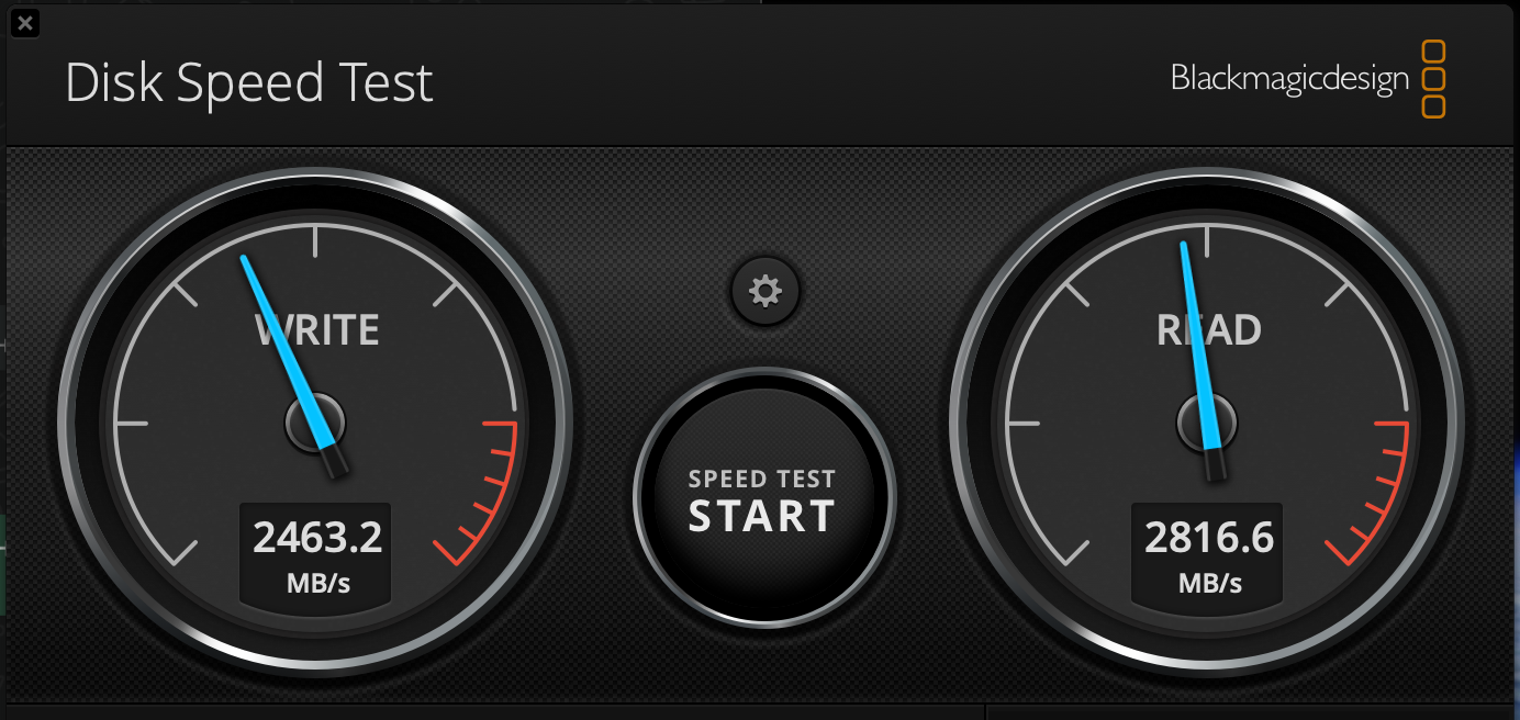

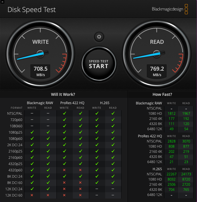

You wont really feel big difference at everyday use (Apple blade SSD vs the SATA Samsung).
But if you would use a standard mechanical hard drive, than yes, there would be quite a different feel.

Its performance is better than the hard drive it replaced; it's worse than a factory SSD (blade) would have been. So it depends on what you're comparing it to.
Certainly it's an upgrade from how THAT Mac was originally equipped.
