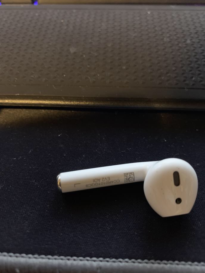

AirPods usually have it on the stem, as well as inside and outside rear of the case. The specific AirPod for example has it serial number, and is in EVT (Engineering validation testing) stage as denotes by the EV, and likely a 2nd iteration since EV2. AOI likely refers to Automated Optical Inspection, looking for any external defects basically.

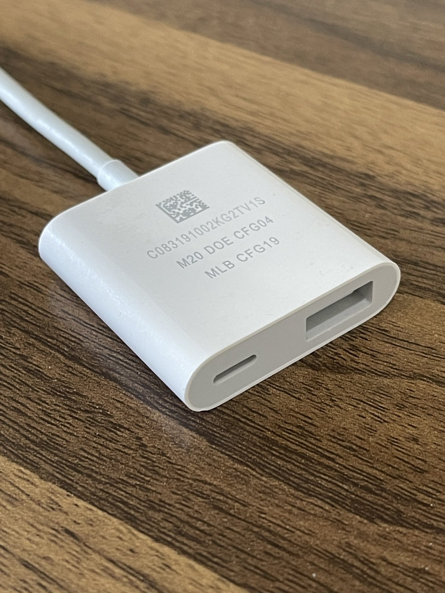

IMG_7178.jpegSmall accessories like adapters and cables will often have it on one of the connectors, or if the body is big, then the body. This particular Lightning Camera Kit adapter is actually an amazing example for how to understand some of these.
  • First line is serial number
  • M20 is the internal project codename similar to how iPhone iPhone 13ProMax is D64 internally or Mac Mini m2 is J473
  • DOE is Design of Experiments, which is a stage where they often make really small changes and see if that has any impact on manufacturing or reliability or other areas of problem solving and manufacturing optimization
  • CFG04 just means that it's the fourth configuration a.k.a. fourth variant of this product type
  • MLB CFG19 just refers to main logic board configuration 19, a.k.a. the 19th design variant of the internal circuitry on the logic board.

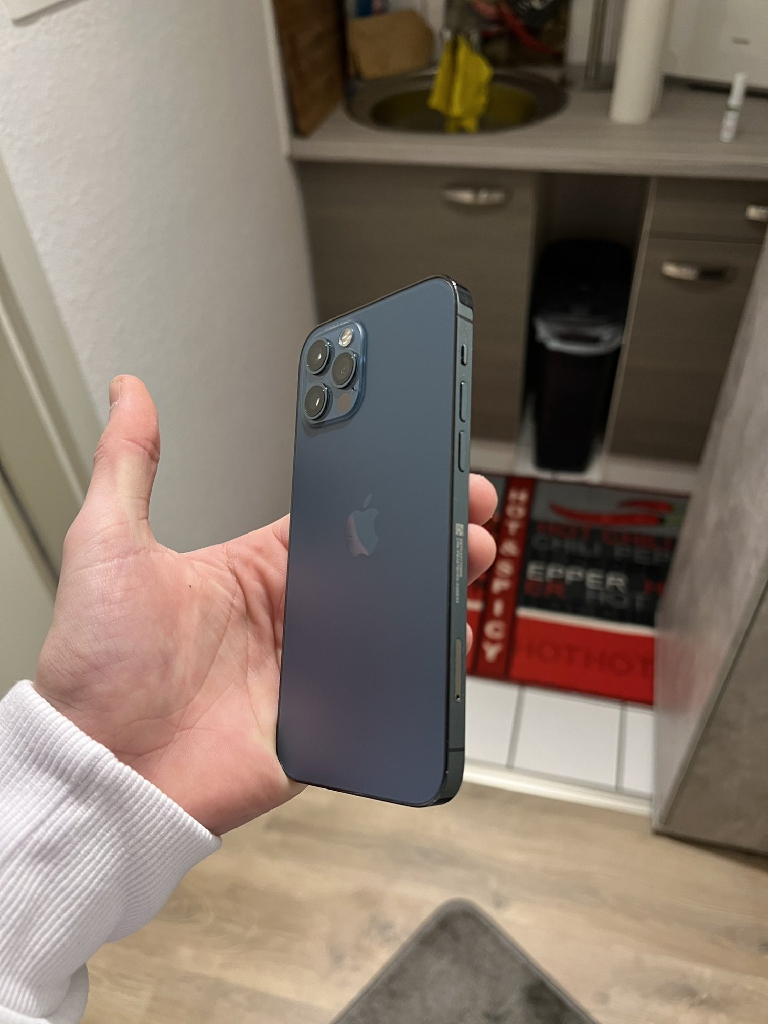

iPhones often have it along the edges

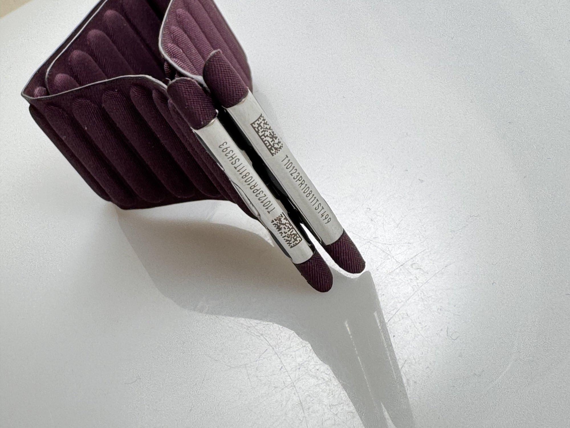

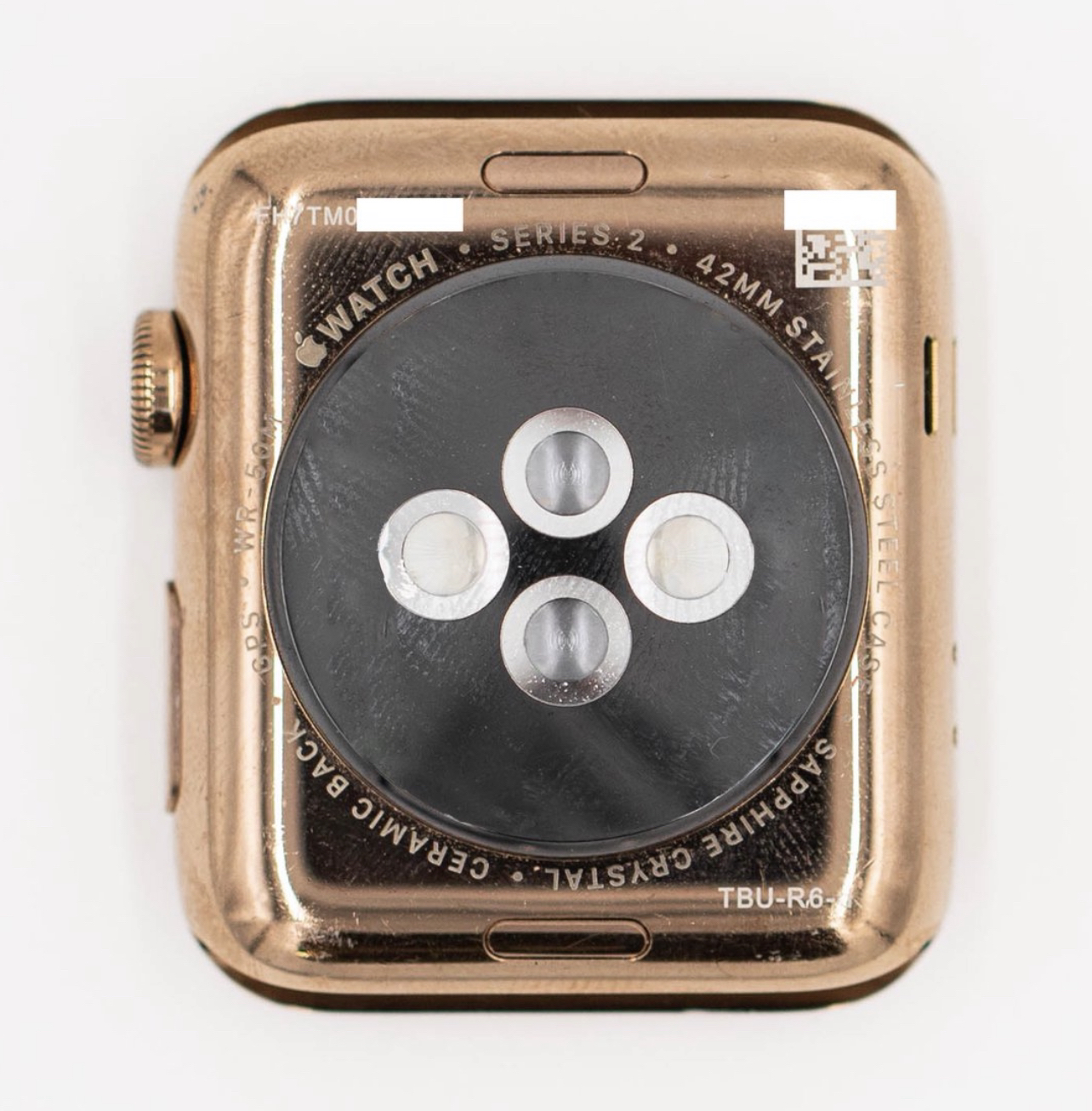

Apple watchbands are often on the inner lugs. Sometimes it's just a serial number, sometimes it has a datamatrix as well

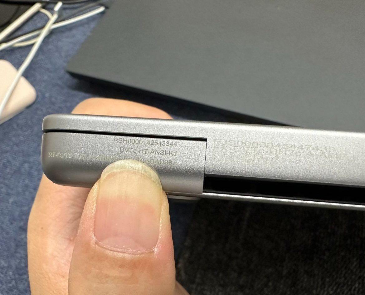

MacBooks will be along hinge areas and rear facing bits. This one for example in in DVT (Design Validation Testing) stage as denoted by markings, which is the stage where a lot of the major engineering hurdles have largely been taken care of and this is just validating that the design is reliable structurally and electrically and in terms of safety and manufacturing and all sorts of other aspects of design.

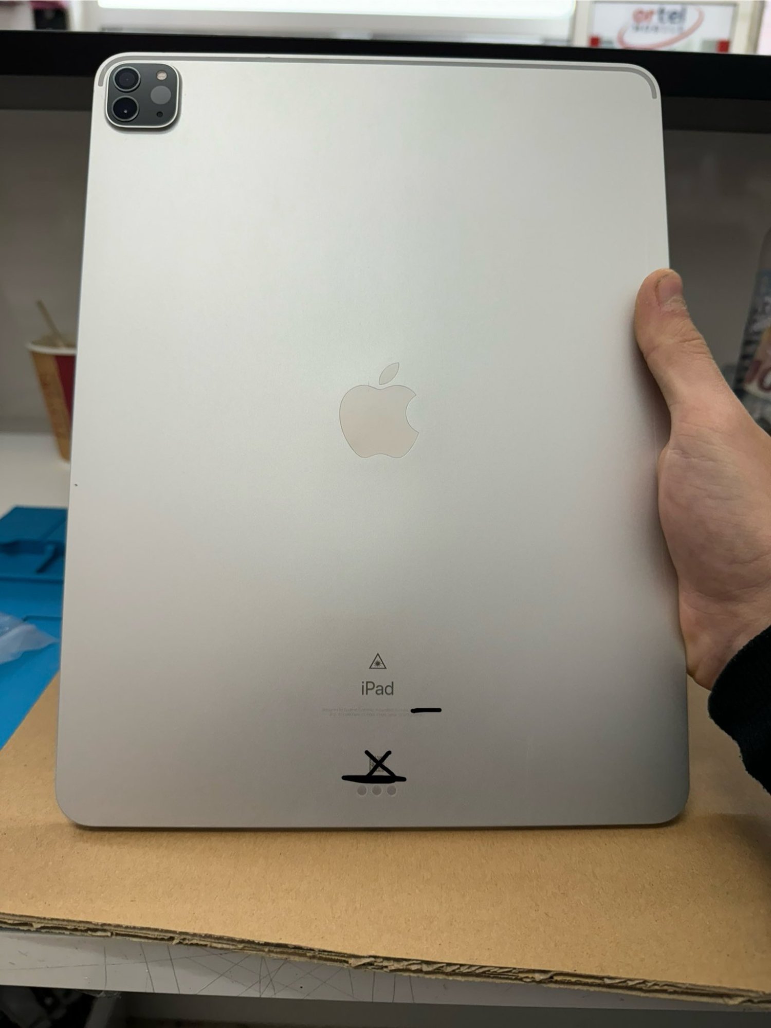

iPads will almost always be on the back of the unit to towards the bottom. Prototype/development iPads and iPhones also will often have a laser icon edged somewhere on them if they are a Face ID enabled product. It's basically something they have to do things to US regulatory bodies whenever any sort of laser or laser-like hardware is involved.
