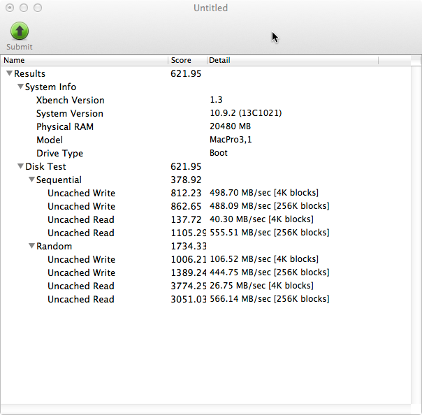

Thanks very much for the further explanations. Thanks also 666sheep for suggesting Aja System Test and Xbench. I have now run them both and get the following.
I couldn't run AJA booted from the Sonnet's striped array but when booted off another SSD and run on the array I got reads around 850-1100 and writes approx 900 for most settings. For some settings, for instance the NTSC DV25 setting, the numbers dropped to around 500 on r/w.
Questions:
Why is Xbench's Unchached Read on 4K blocks so low?
Why do the numbers drop on some of AJA's settings?
About the compressed data thing - I mainly use the system for working on (sometimes rather large) Photoshop files (film scans actually). Do I then use "compressed files"? If so, I guess I shouldn't have bought Sandforce-based SSDs.
Overall I think i should be happy with the tests but honestly I don't really know what to look for so would appreciate your honest views.

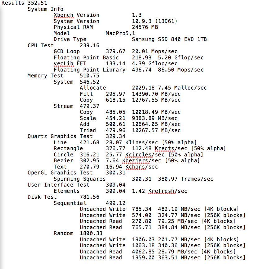

This is interesting, I have only one 840 Evo and mounted it on a Sonnet Tempo SSD. The Xbench result like this.
It seems the 4k and 256k performance has no relationship at all. compare to your result, my SSD perform better on 4k read/write, but much slower for 256k read/write.
