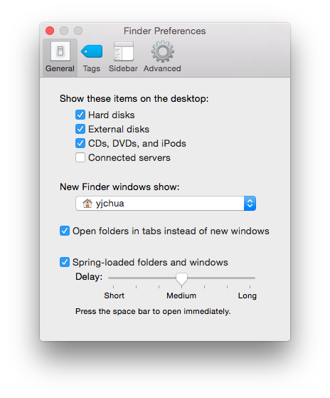

Open Finder Preferences (click anywhere in the desktop and press Cmd+comma), and match these settings in the screenshot.
PS this should have been posted in the OS X area, as it's a software problem.

Trust me, I already tried that. My settings were already like that for the most part.
