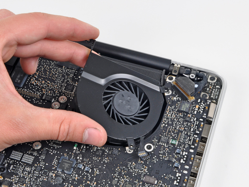

xMKfOIWvUcHXWSKH.large
Sounds like you forgot to plug a temperature sensor back in...
Could you expand on this a little more please? I didn't unplug anything when swapping the HDD over except for the sata plug. iStat pro can monitor the temperature of the CPU so wouldn't this suggest the sensor is plugged in 😕 How do I check if the sensor is plugged in and working?

Do you also think it could be a sensor problem as mentioned by throAU?
Hmm, I think I may have an issue with a sensor monitor. I've just downloaded a program called temperature monitor http://download.cnet.com/Temperature-Monitor/3000-2094_4-41089.html and it gives temperatures for CPU core 1, 3 and 4 but CPU core 2 just reads --- Does this mean something's wrong, how can I fix it?
Update on the post above. Whilst I was converting a video from.mov to MP4, temperature monitor didn't register the CPU Core 2 temperature, and Core 4 kept going from a temperature reading to ---. Now the video conversion has finished and the CPU's cooled, Core 2 is now reading a temperature, in fact all 4 are reading a temperature.
Actually as I'm typing this, Core 2& 4 have just gone again. Do I have a problem with my computer or not?
Open the case back up and check for any loose/disconnected cables. It should be a 2 wire cable with a small plug on it.

check ifixit.com for the relevant macbook teardown, and check for any of the temp sensors mentioned...

I haven't pulled the drive out of my macbook yet, but i had a similar problem with my mini - forgot to plug a sensor back in and the fans went berserk.
Basically the fans will spin up when
- the temp gets hot
- the temp can't be measured due to sensor unavailability/failure (this is a fail safe - "if i can't read the temperature, i'll assume it's hot and try to cool down!")
Where in particular should I be looking, near the fans? I don't see why this should have unplugged itself though 😕

I'll open it up shortly, but the only cable I unplugged was the sata, and I've not heard anything about temperature sensors being on the sata plug for macbooks.
I want to clarify that the fans aren't running fast all the time, only when rendering HD video, or importing large photos files to a program. Using apps, web browsing, transferring files et does not cause the fans to spin up.
Now the temp is reading unusually low, it's reading 44 degrees :/
check the ifixit.com teardown.
if you can't find/fix it, you may have to live with it or get apple to check it out.
