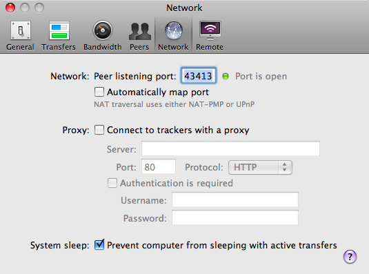

My favorites are 27218 and 43413.

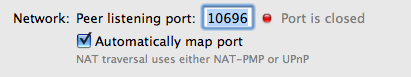

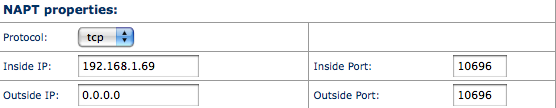

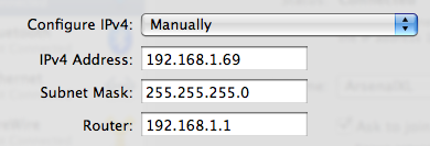

Ok It didn't work. 🙁
Here is what i did:
1rst: Set my router to forward port 10696 and ip 192.168.1.69
2nd: Set my ip to 192.168.1.69
3rd: Set transmission port to 10696

I needed my DNS to configure my internet connection and manually set an ip.
Here is what i did:
It's UDP not TCP.
It's UDP not TCP.
Ok, I did that and still no open port. I called my ISP and they told me I am behind a NAT, and my public ip is shared with other users. So whatever is configured in my router isn't what is directly shown on internet.
