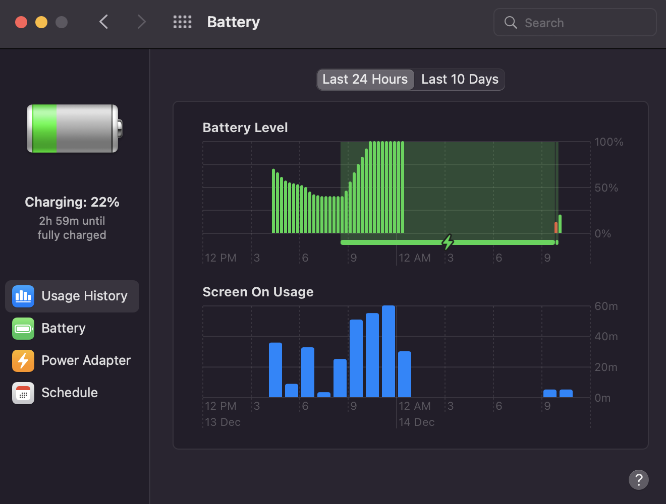

Hi, thanks. Yes power nap was turned off under battery, have also turned it off under Power Adapter. Will monitor again tonight.
There's nothing in schedule, everything is all off.
Also, plot twist, Apple reformatted my computer, and I did not install Adobe this time, but my battery still drains.
I'm just wondering, even though my laptop was not plugged in, there is the plugged in indicator. So maybe it activated power nap and it just kept running even though it was on battery? So somehow the computer thinks it's plugged in even when it is not?
