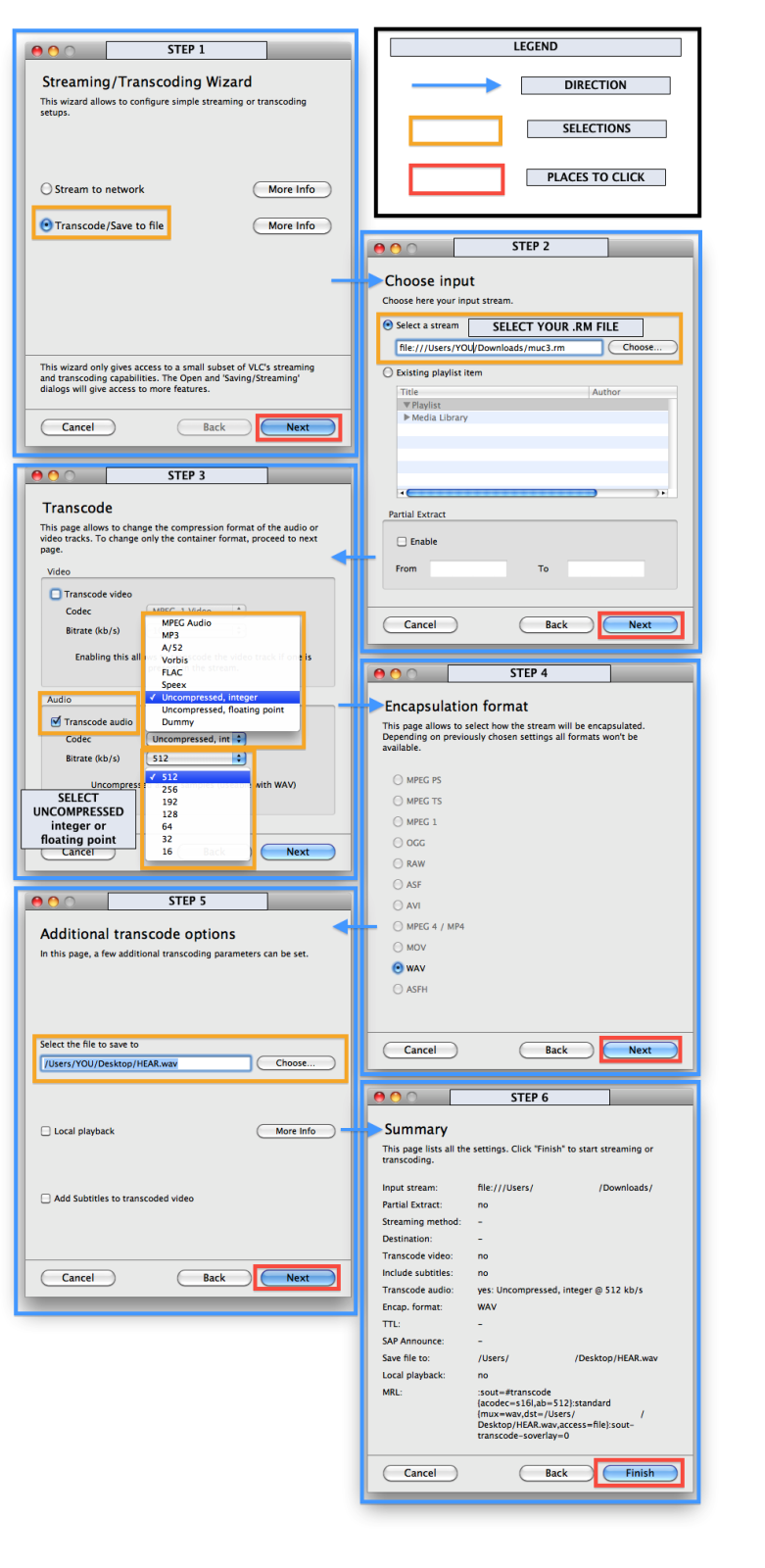

Use VLC Player and its Streaming/Exporting Wizard (Shift+Command+W) and export it to .wav (Uncompressed, Integer or Floating Point, 512kbps).
It worked for me and I got a .wav with 1m13s length and 3.2MB size. I compressed it and I can't attach it via the Attachment function of this board, as the maximum file size for .zips is 1.x MB.
Thank you so much for your help! I can't seem to figure out what to do when I get to the screen "Additional Transcode Options." It doesn't seem to want to create a file, but it wants me to select a file instead. What do I do in this situation?
No problems, I sorted it out. Thank you so much for your help! You did in 10 seconds what Real couldn't do in a morning.
Here are the steps, sorry for the screenshot, but I like using Preview too much.
