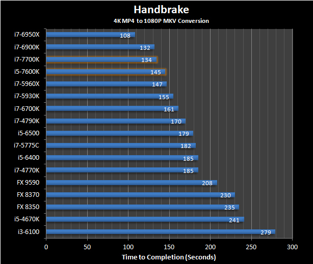

I think I know the answer already, but I can't find any benchmarks to confirm. Unless I just don't understand the benchmarks that I've seen - which is possible. Basically I'm trying to decide if the 4.2 i7 vs the 3.8 i5 will give me noticeable, time saving differences for my use. I've been doing more video editing and encoding lately. Lot's of time taking clips from friends and family from weekend trips, parties, backyard fun, etc. and mashing them into something watchable and catering to everyone's formatting needs. I probably mess with a few hours worth of video, editing and encoding, per week.
I'm wondering if anyone can tell/show me what sort of time savings I could expect with the i7 over the i5. I know that can be vague, so maybe the following chart will help give you an idea of what I'm looking for. In their example the i7 was only only 11 seconds faster at the conversion. Since it was only a 6gb 4k file, I'm guessing it was only a 60 second clip or something small.
Image from http://www.hardwarecanucks.com/foru...tel-kaby-lake-i7-7700k-i5-7600k-review-6.html
If the i7 will save me 10 or 15 minutes per hour of video, to me it would definitely be worth it. But if were talking maybe a minute or 2 tops, then it's not. I'm not looking for someone to give me an exact amount of time savings, I know that's not possible, I just want to know really if it's noticeable. I'm just guessing, but I'm guessing that hyperthreading of the i7 will be noticeable the longer and longer it goes. So while this small file didn't have much of a difference, when we're talking hours worth of video, the difference will start to be more and more noticeable, but I'm not sure.

The benchmarks you listed are showing about 8% difference in speed. While I trust hardwarecanucks I feel that is the absolute minimum difference you will see in transcode times between the 7600K and the 7700K. Other reviewers have shown up to 30% difference in Handbrake. Average user benchmarks at Userbenchmark shows about 18%.
Regardless the amount of time saved will come down to the project. If it takes you 5 minutes to export something then 8-30% faster isn't that big of a deal. However I've transcoded bluray rips and my own projects through Handbrake on veryslow, with high levels of denoise and other filters and its taken 7+ hours. 8-30% of that is significant, in theory that could be 2+ hours of time saved. (I'm using an i5-4670 which is ~50% slower on average benchmarks than the 7700K so keep that in mind).
If you don't mind fan noise I would go with the 7700K. It will benefit your particular workload and offer features your particular type of workload can benefit from like hyper threading.
Both the 7600K and 7700K have TDP of 91w but the 7700K will run hotter. I've found anything over 85w TDP as rated by Intel will cause the iMac fan to lift off the 1200 RPM minimum under heavy load. I haven't done any research but I would be curious of what 7600K owners have experience fan wise under a heavy load like transcoding for long lengths of time.
