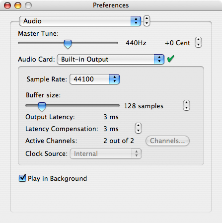

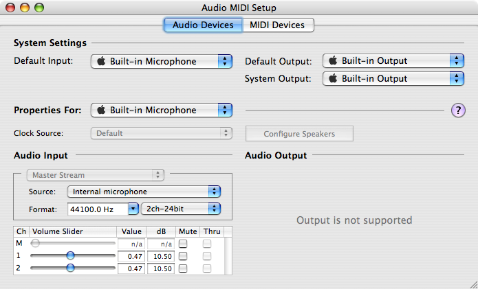

Can you take a screen shot of the Audio/Midi settings in OS X and then the Audio prefs in Reason?
You should have a file called "picture" on the desktop (or in your Documents folder).
Use the manage attachments option under you reply post to add the image to your post.
Here are the pics. I hope I took the right ones 😕

The latency seems very low, try setting it a little higher.
EDIT: Audio midi has a little app in the Utilities folder I think.
I don't have my PowerBook with me at the moment, so I can't check.
Oops, I had accidently left it at that. I had changed it around and hadn't seen a different really. It was originally at 512 and still doing it. Any other ideas 🙂 ?
AHH! Got it to work, I set it really high and now I am good. Thanks for your help! Good to know there are people out there that will help with macs haha.
Slowly lower the latency and see how low you can get it without problems. Then leave it at that.
