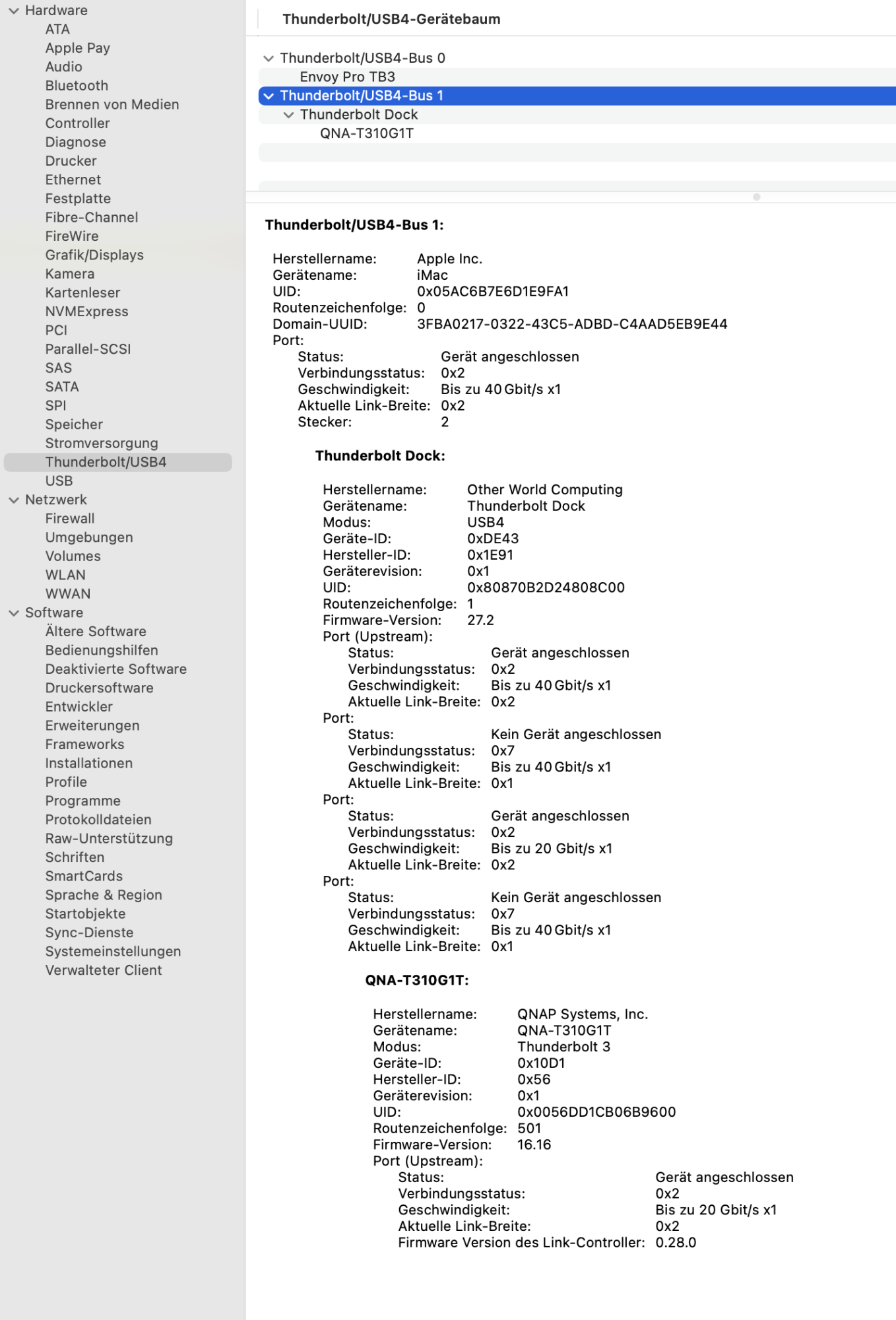

What does the Thunderbolt tab in System Information.app show?
Also the PCI tab and the USB tab.
When you plug the adapter directly in the iMac, is anything else connected? Can you remove any other connected devices to see if the iMac can provide enough power to the adapter?

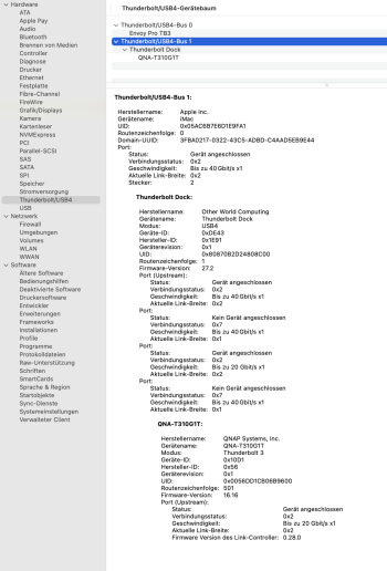

The adapter is detected.
My usual config is like this: iMac - 50cm T4 cable - OWC T4 Hub - 2m T4 cable - QNAP adapter.

That is suggestive that there might be a problem with the adaptor, not the Mac. You can try the other TB port on the Mac and also to try to find someone's Mac ( TBv3 or TBv4 ) port to see if message is the same. If the same message across multiple Macs then pretty good chance it is the adaptor. The T4 hub may get the power handshake error and just squash it and just provide a lower/'safe' amount it thinks will work.
If the message goes away on another port then that port has an issue. Similarly can rotate the downstream connection to another port on the T4 hub. The system report diagram suggests it is at the end. Put it first on the hub and see what happens.
