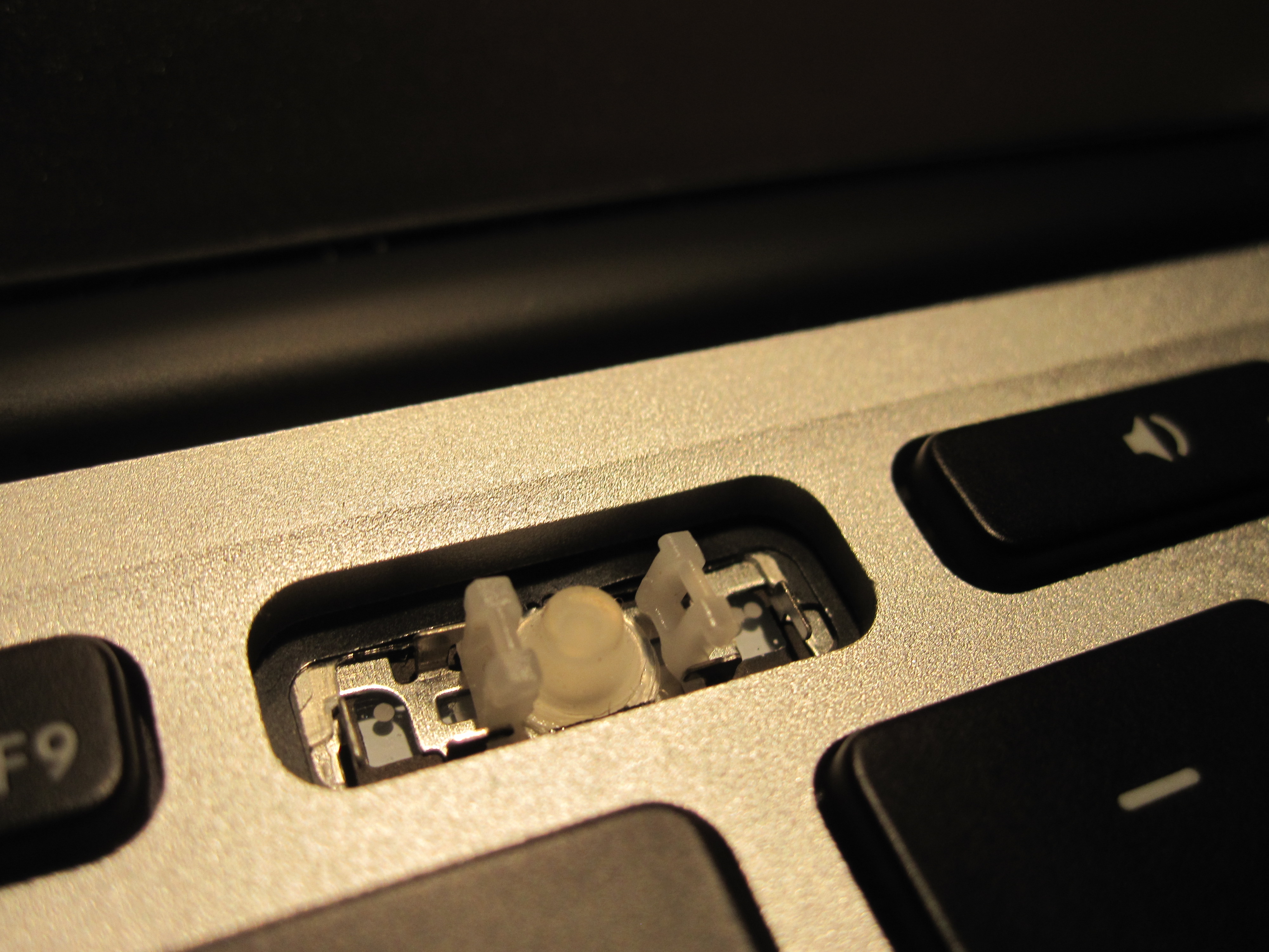

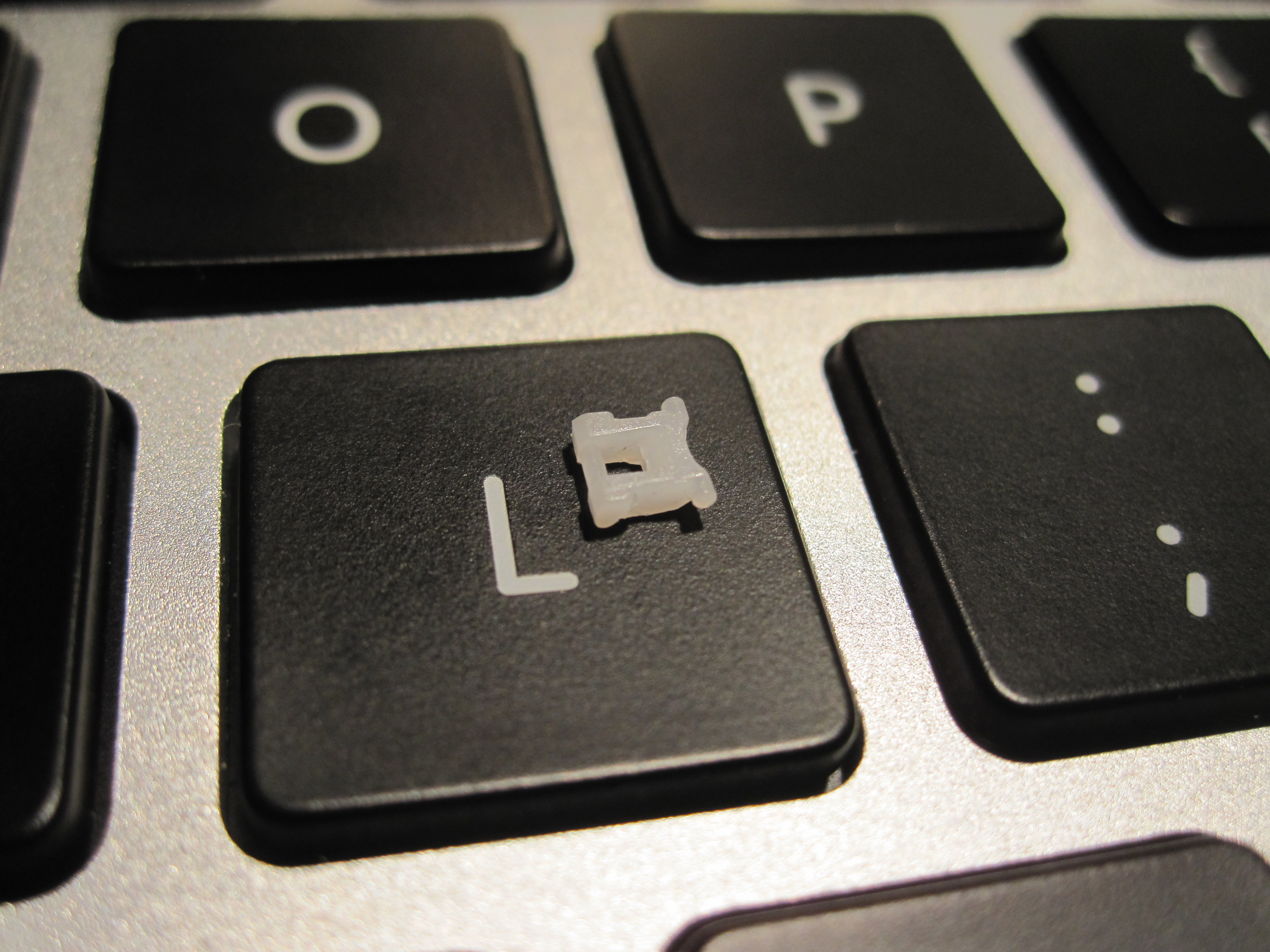

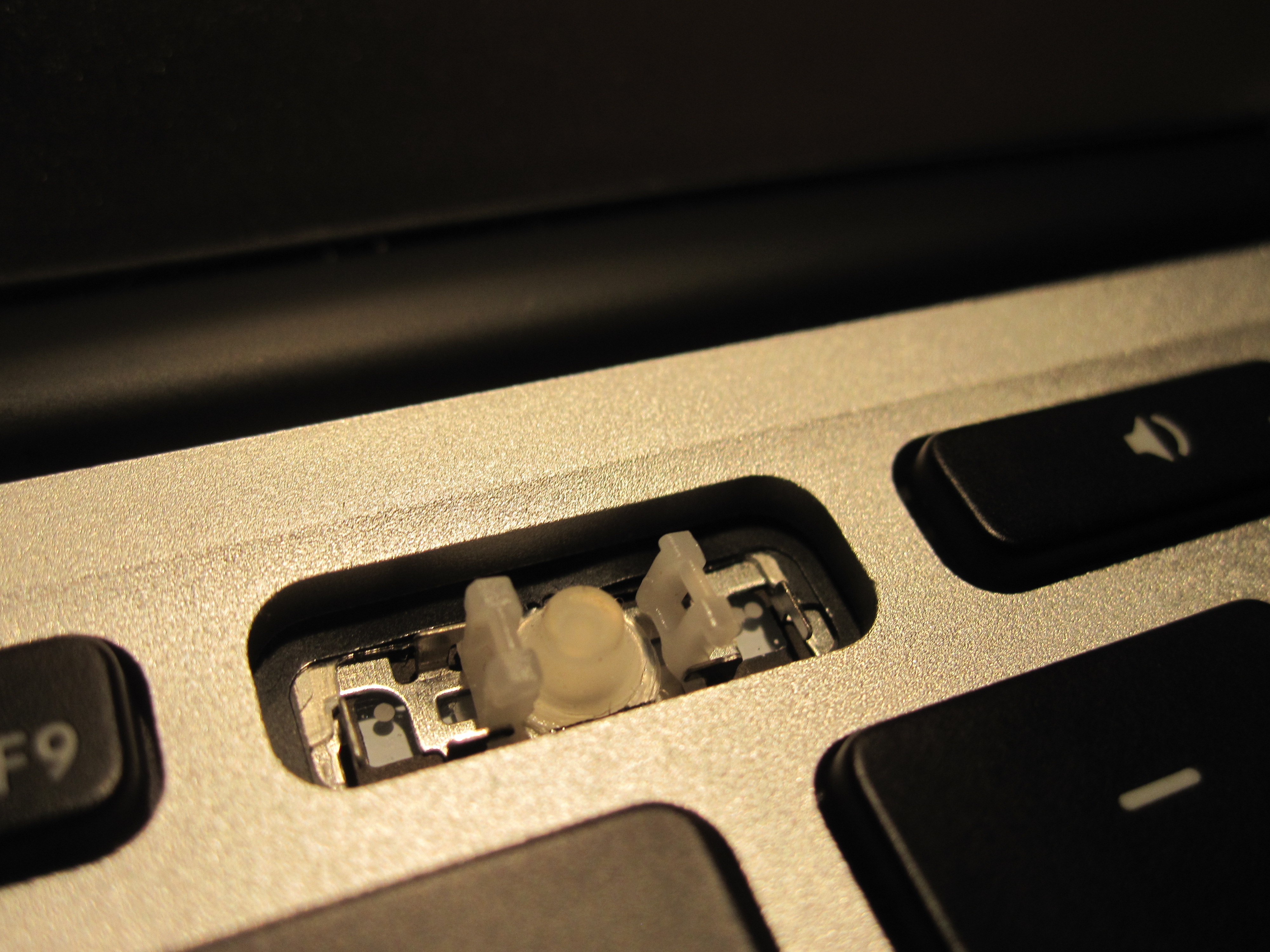

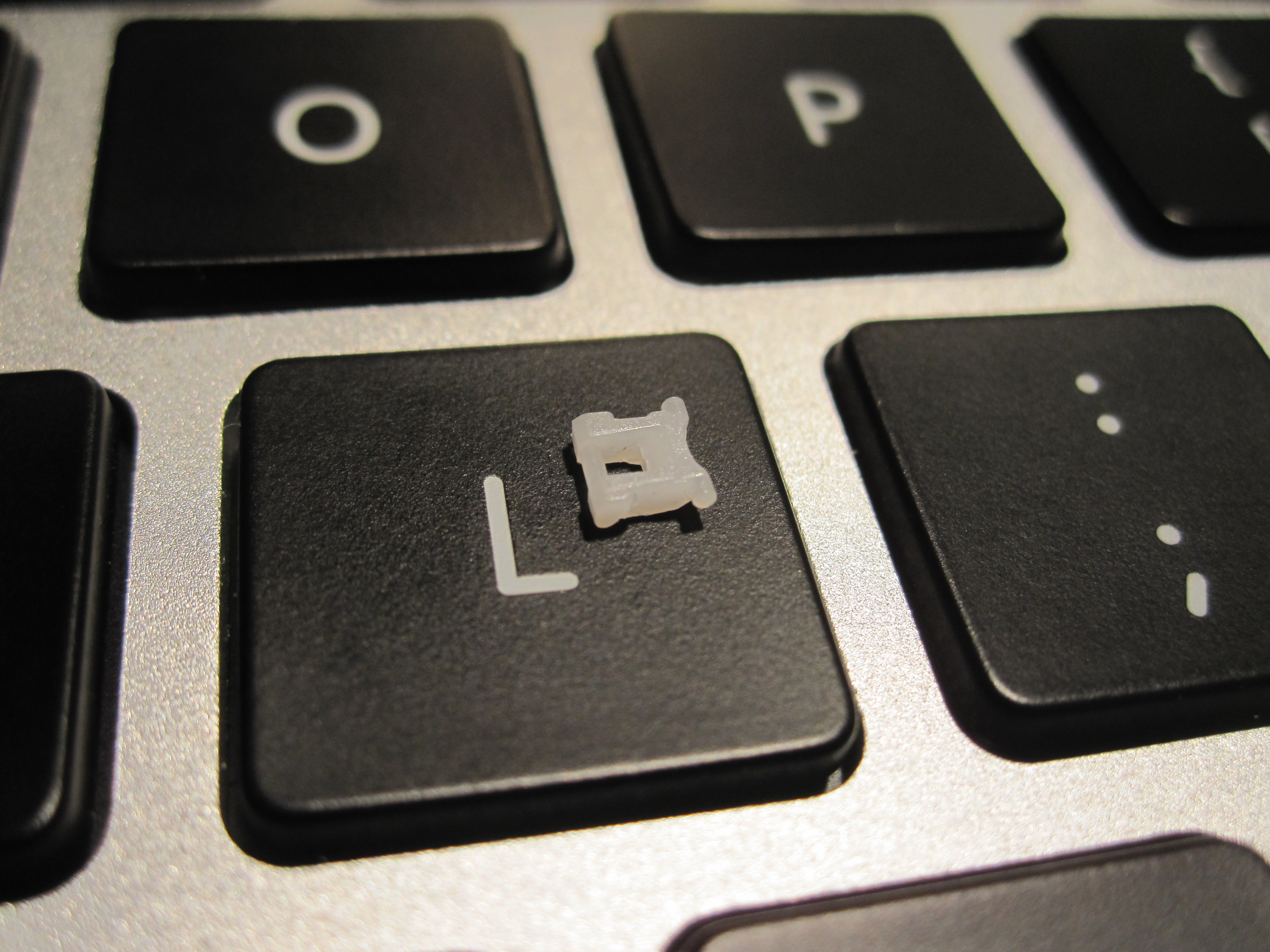

The plastic "scissors" mechanism on this key is comprised of two of these:

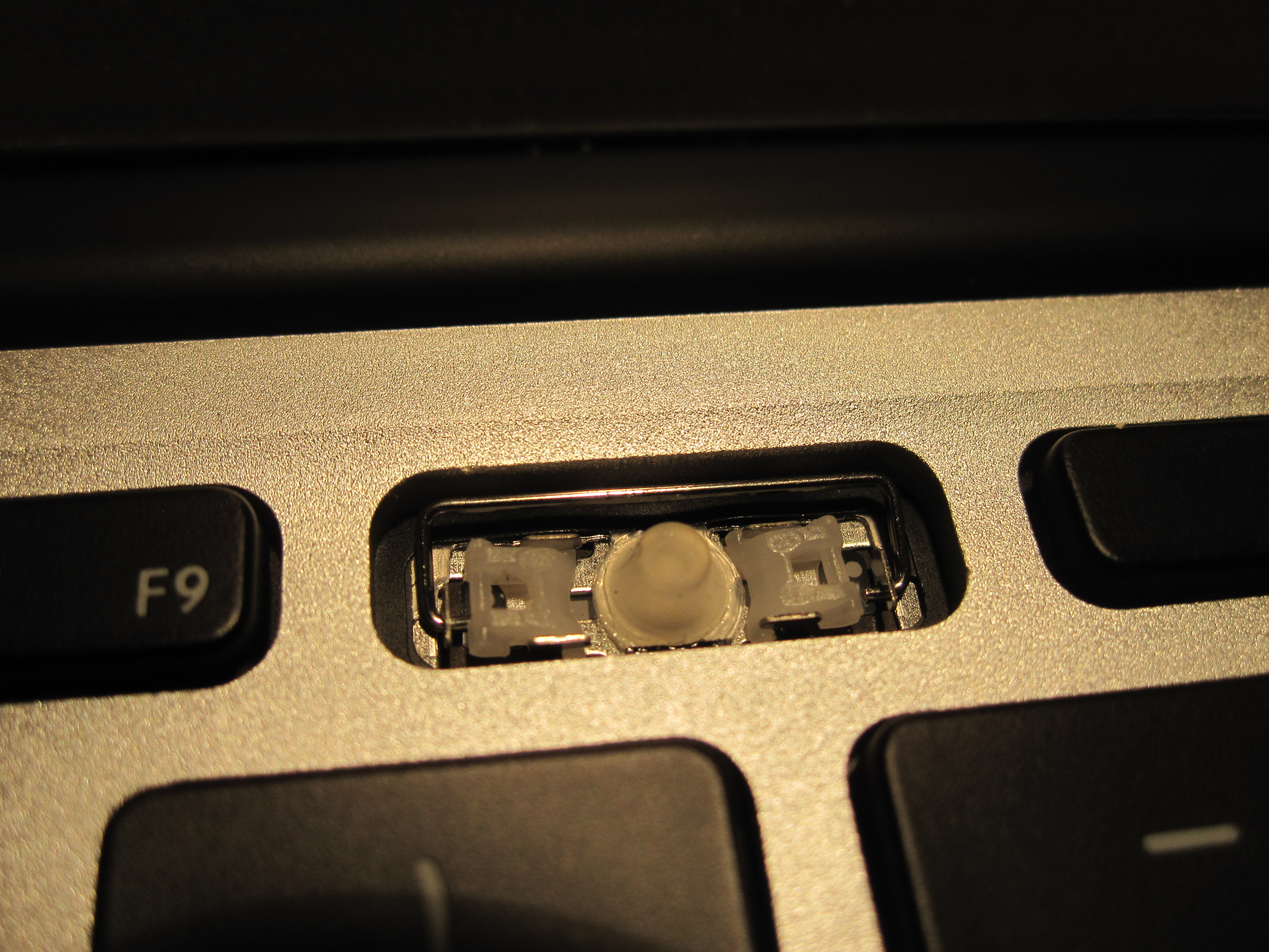

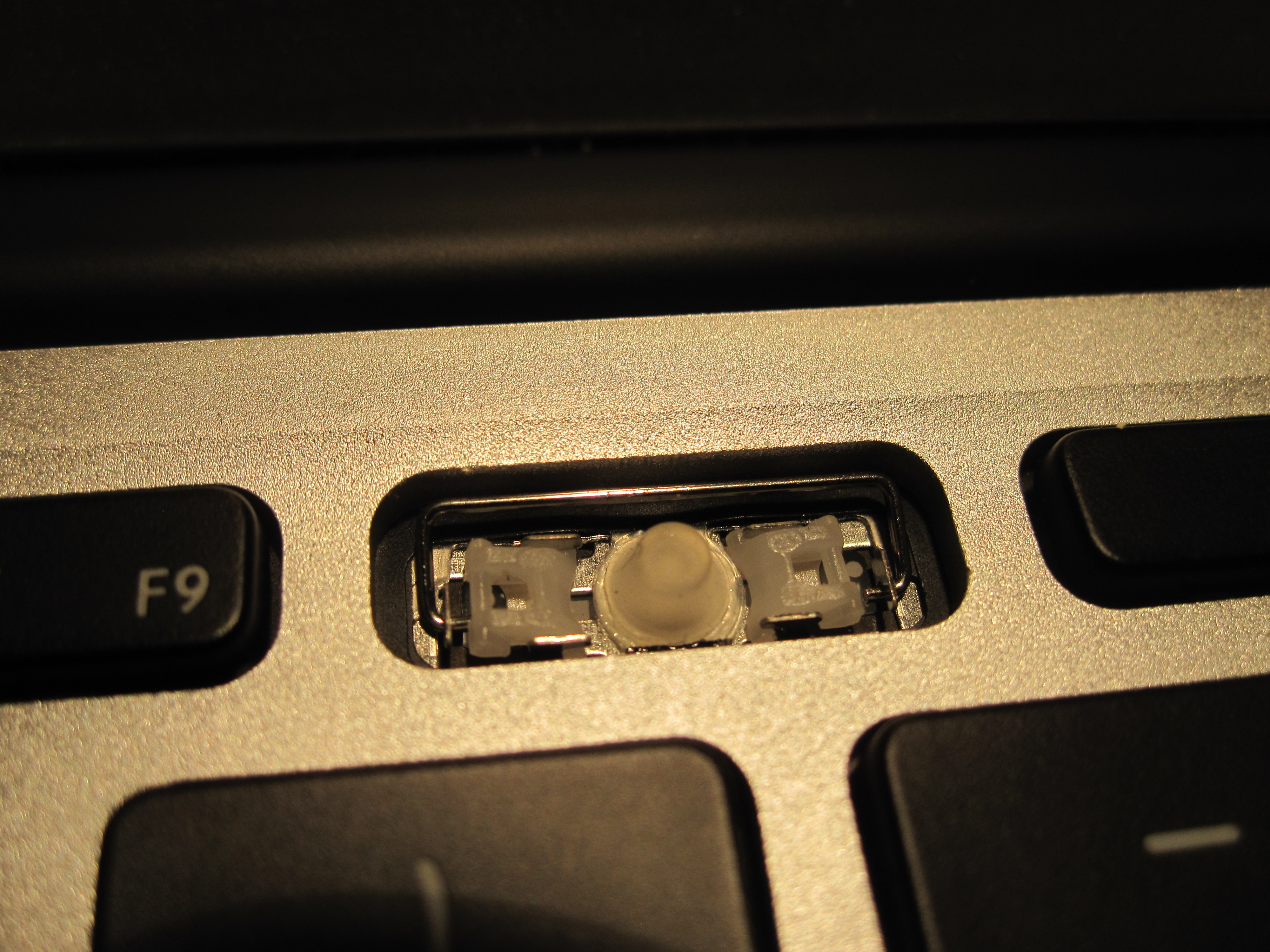

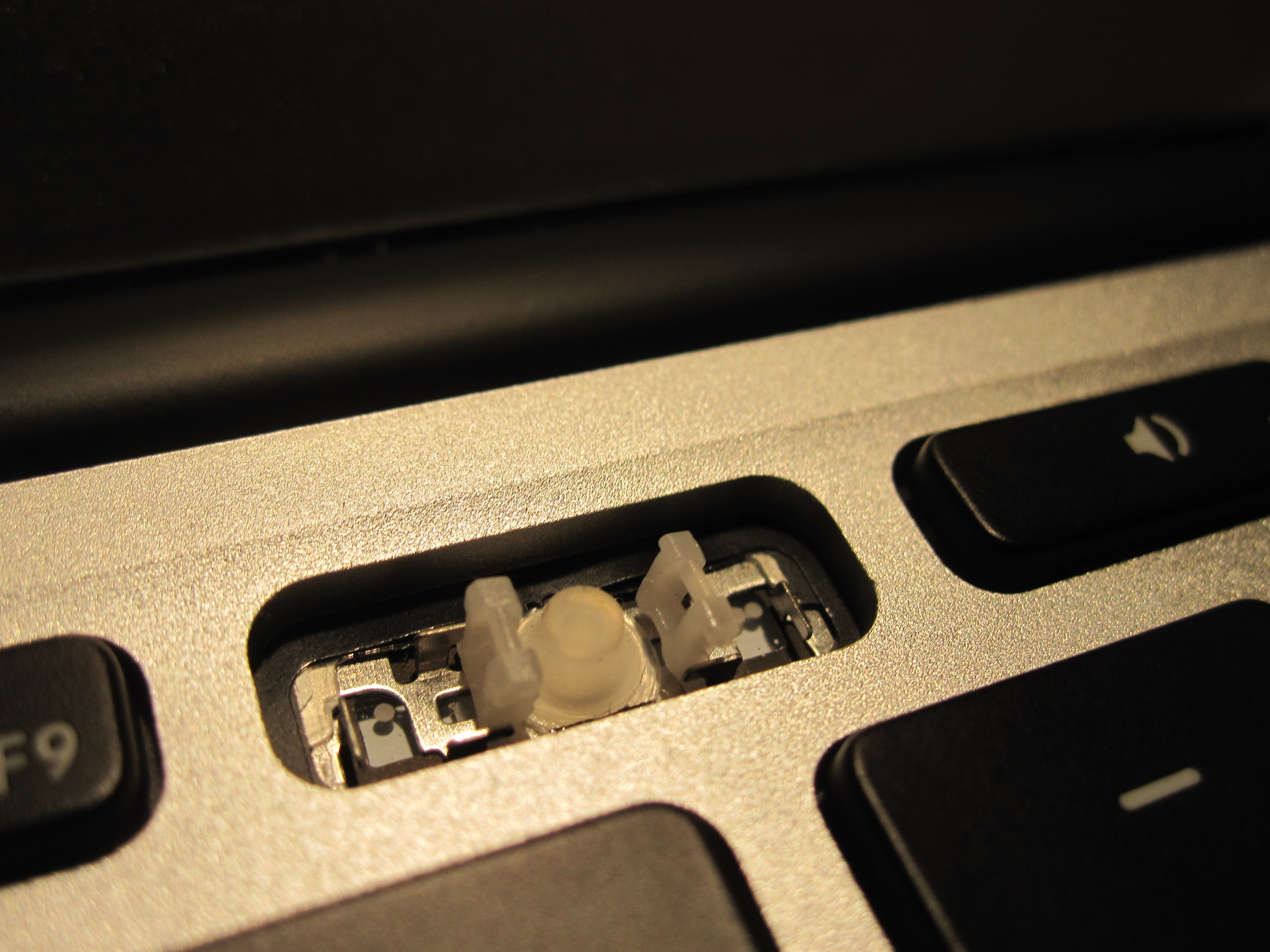

After a lot of trial and error, I realised that they need to be slid into two grooves either side of the plastic nub. When done correctly they can stand up:
Finally, there's a hinge clip that can be slid under two metal tabs all on its lonesome:

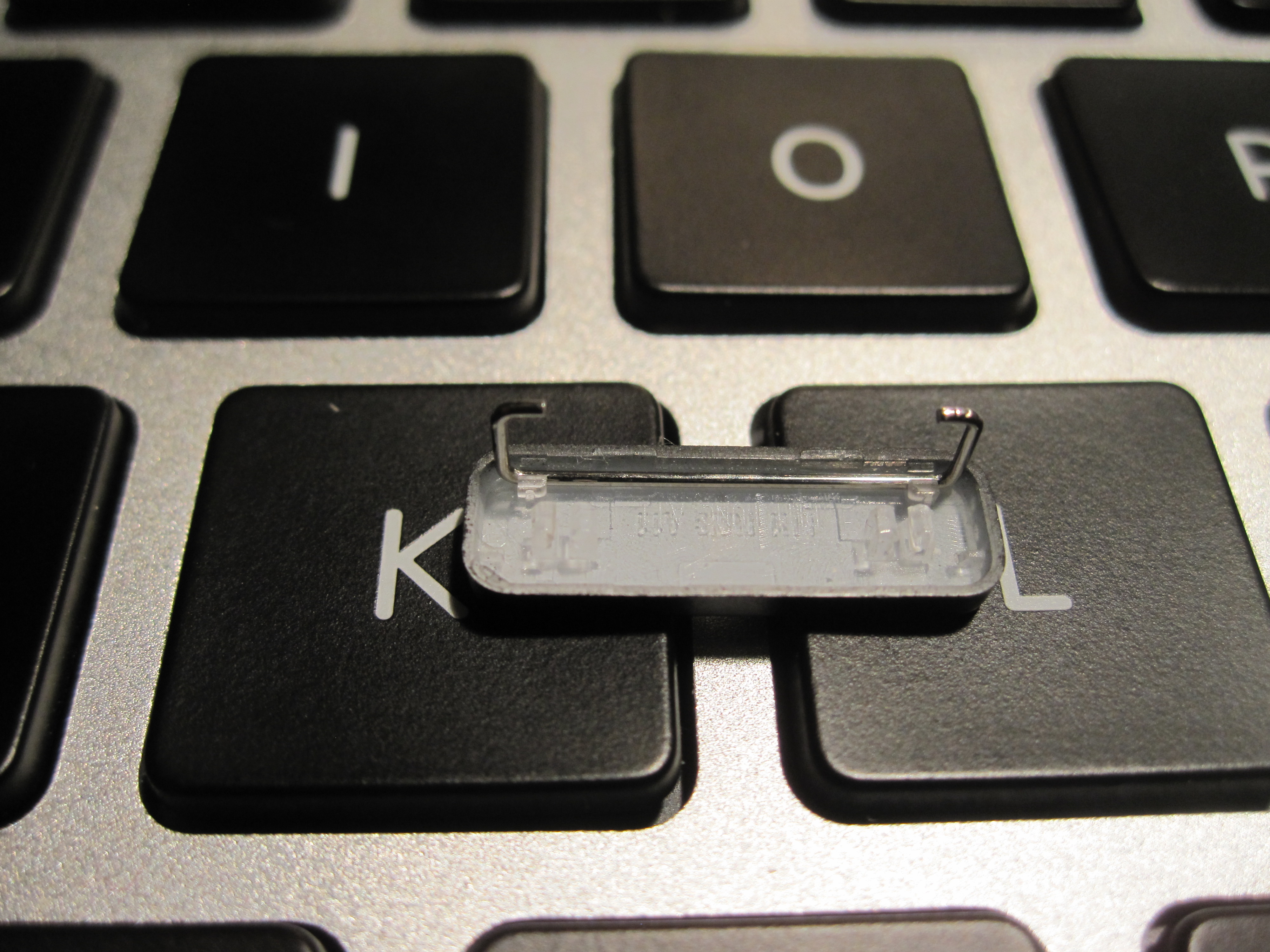

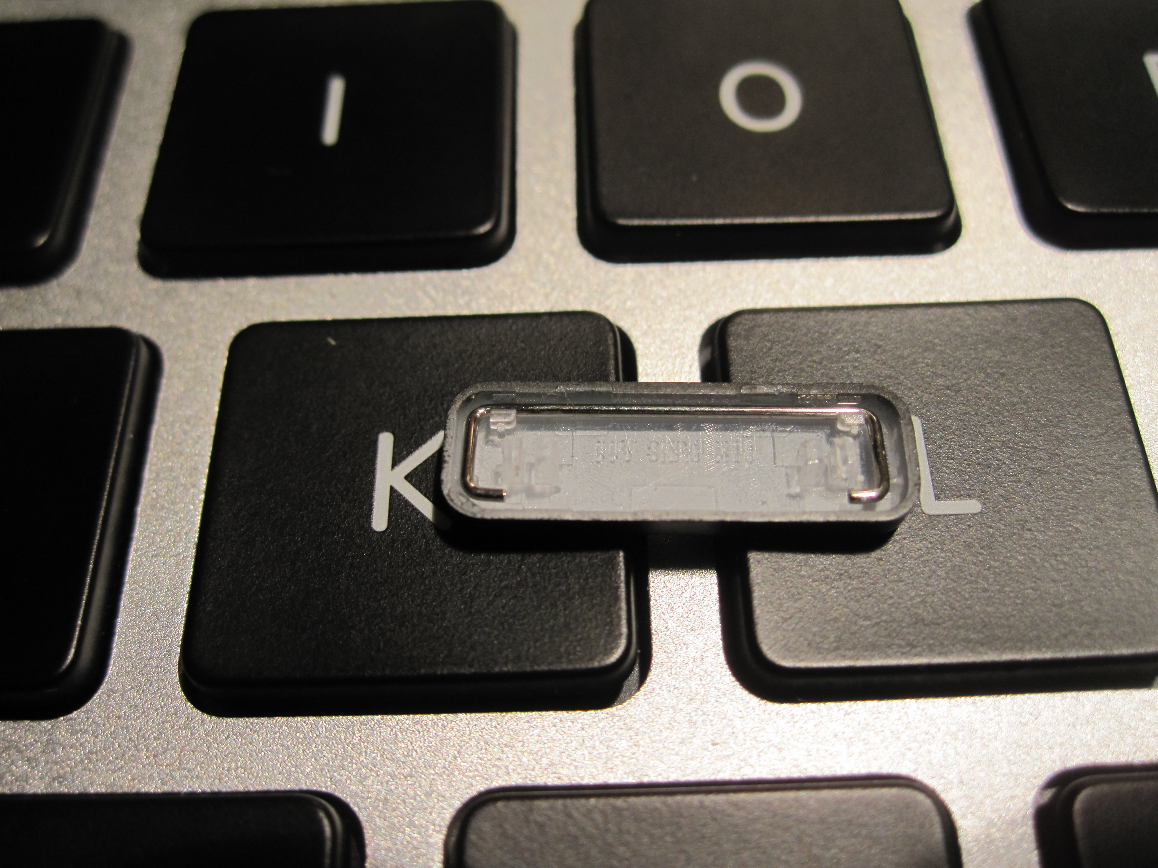

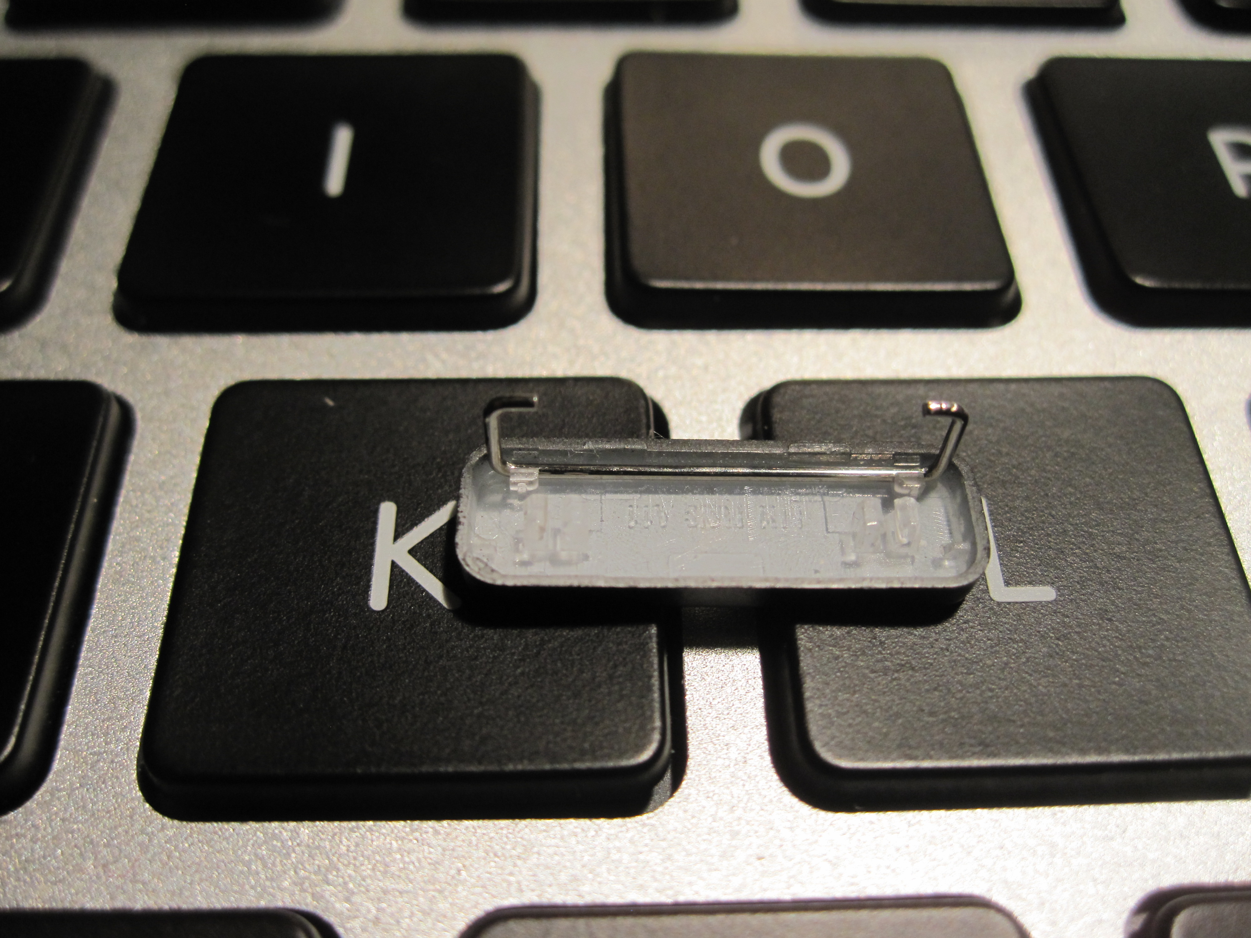

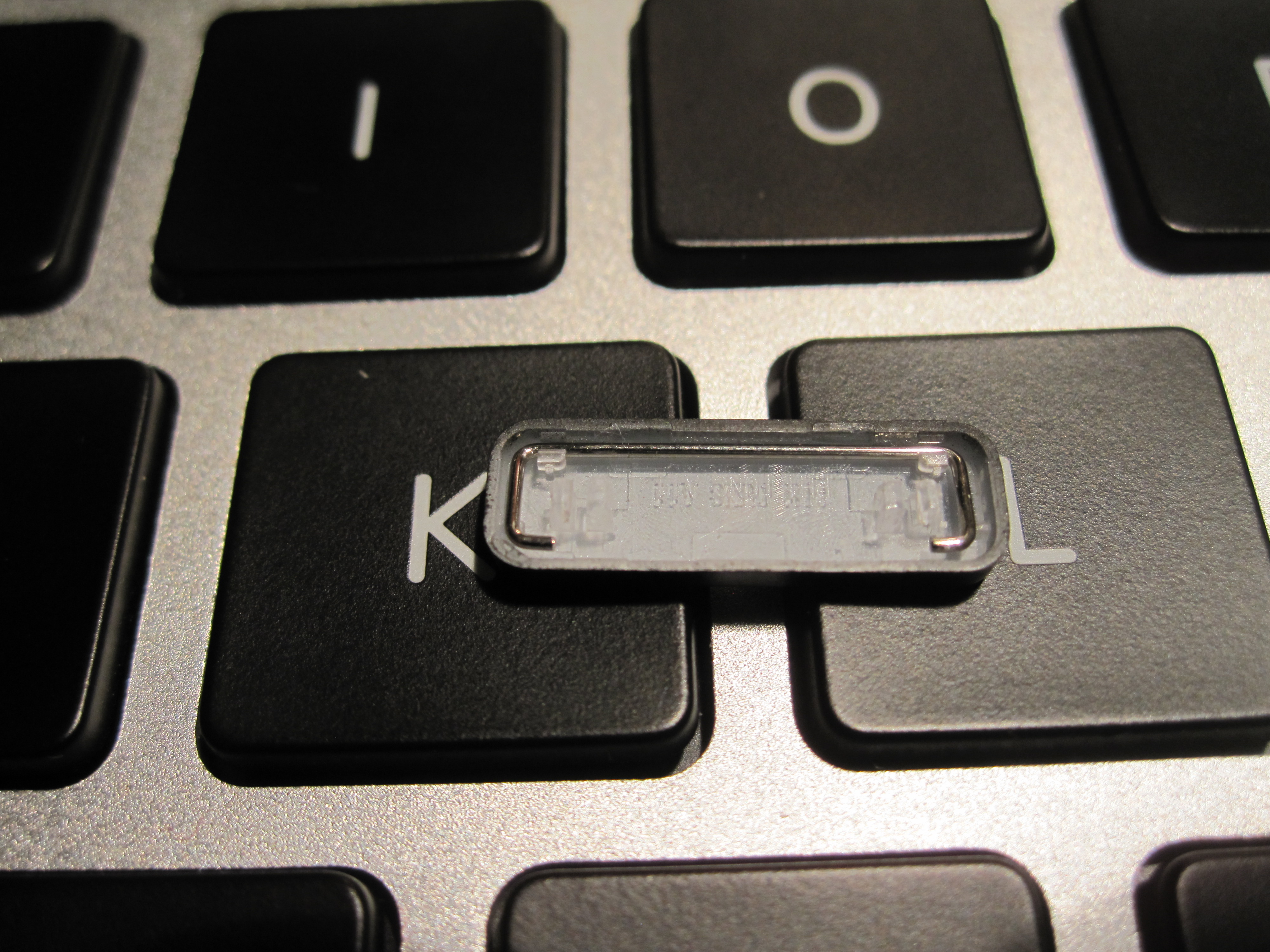

I repeatedly tried clicking the keycap into place on top of this with no success, realised it was because the clip and the key need to connect together like this:
However, simply pushing the keycap on top couldn't make that connection happen. So, I added the clip to the keycap first:
And then, holding the hinge clip and the kaycap as one assembly, I maneuvered the left side of the clip under the left tab, then the right end under the right tab, then clicked it down and forward into place.
