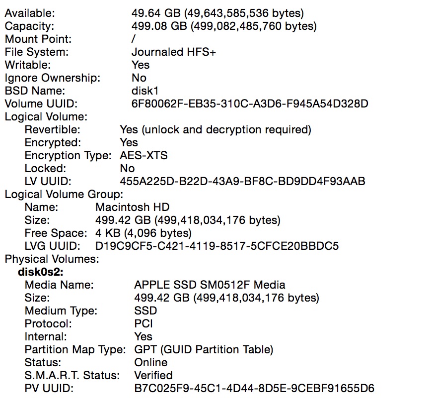

if you can click on "about this mac" and pull a system report in recovery mode, ( i forget if its possible ) go to the storage tab on the left, and look at the screen to make sure it says "smart status : verified "
they used to put smart status in disk utility, but i think it is now been removed
if it says "unsupported' it means you have an internal hard drive in a usb enclosure
if it says anything else but "verified" your disk has been damaged and it needs to be replaced, period
it looks like about this mac is not in recovery mode, sigh
if you go to terminal and type ' diskutil info disk0 | grep SMART ' it will tell you your smart status no matter what os x version you have. if you have more then one disk , type 'diskutil list'
if you run disk utility and your hard disk is greyed out, and you can't click on repair permissions or repair disk, it is because it is locked by file vault, right click your hard disk, and select unlock, and enter your login password to unlock the disk
