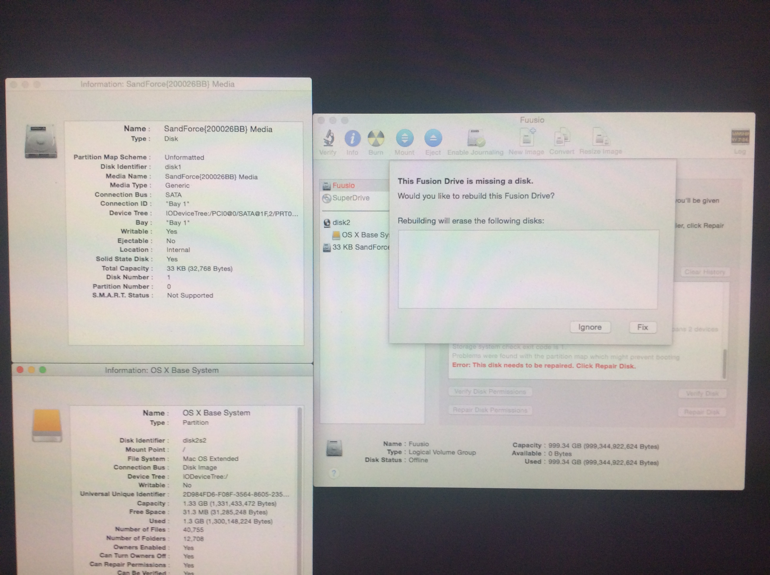

My ssd from selfmade fusionDrive in my cMP died. After booting to recovery mode and opening Disk Utility, It shows my fusiondrive in red. Then it says "The Fusion Drive is missing a disk" AND after "Rebuilding will erase the following disks:" and then the white box is empty?!?
Does this mean, that it won't erase the content in hdd?
Or is it just not able to see the name of the volume, since ssd is missing?

I'm going to -guess- that if you let disk utility "rebuild" the fusion volume, that you're going to lose everything that was previously stored on BOTH drives (HDD portion and SSD portion).
Hope you have a backup!

According to Apple support documentation its almost certain you will lose the information on both drives if you allow Disk Utility to repair the Fusion Drive.
While I haven't personally used Fusion Drive I don't see how it would would be beneficial to cMP since you have multiple drive bays for drives?
Since Apple doesn't publish details about Fusion Drive its hard to say for sure but based on the information I have found it looks quite similar to RAID-0 which means I wouldn't trust it with important data without being 100% sure all that data is backed up to at least 2 external drives.
Purchasing couple of large drives and making regular backups would be a smart move if you wish to use Fusion Drive or RAID system. Also it might be good idea to make clones in addition to Time Machine backup, relying on 1 backup software may not be the smartest move...
I'm not saying you have further problems with Fusion drive but if you ignore backups and have trouble with one of the drives later its likely recovering files will be very expensive.
Deleting, or re-creating the Fusion drive is a destructive operation and you will in fact lose your data. For any work on your drive, please be sure to have a backup.
