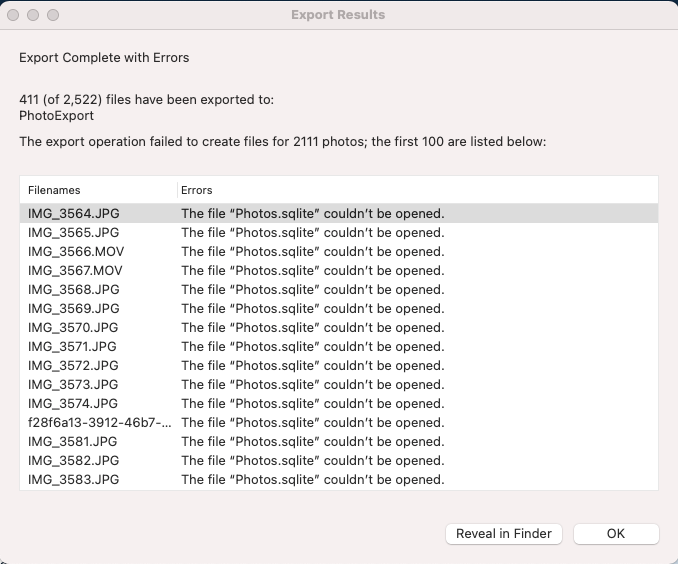

After upgrading to 11.5.1 my Apple Photos library is no longer working correctly:
1) iCloud sync with photos on iPhone are not uploading
2) Original quality photos taken before are no longer available.
3) Stuck at "Downloading Originals"...
I read a thread that suggested exporting originals to "force" photos to download them again, but I get this error.
This looks like the Photos database has been corrupted.
Any ideas how to resolve this? I have time machine backups and a Carbon Copy Cloner backup about a week old I think....

So did you export the files as JPG or were you able to export the Originals? My problems is that only 411 of the 2,522 photos actually export as Originals.

I might just use TimeMachine to retrieve an older version of the Photos library; the Photos.slqlite is inside the "Photos Library.photoslibrary" so this might be an easier solution.
To update my original question, here is how I resolved the issue:
1) restored the Photos library from TimeMachine from the day before the update to Big Sur 11.5.1. This version didn't have the approx 2000 photos permanently stuck in "downloading", but only had the 400 or so "original" photos that had successfully downloaded in the original library.
2) Checked my iCloud library and found the originals were still there (fortunately, I had increased the size of my iCloud storage to allow my complete library to upload - well worth the $1 per month for 50GB I now realise!)
3) Logged out and back in to iCloud on the Mac. This seemed to kick start the Photos sync process and all the originals downloaded from iCloud.
I may have just been able to jump to step (3) with the original library, and I would recommend that other try this first if they have the same situation.
