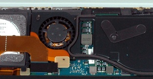

It been 2 years since you bought it, clean this part.
