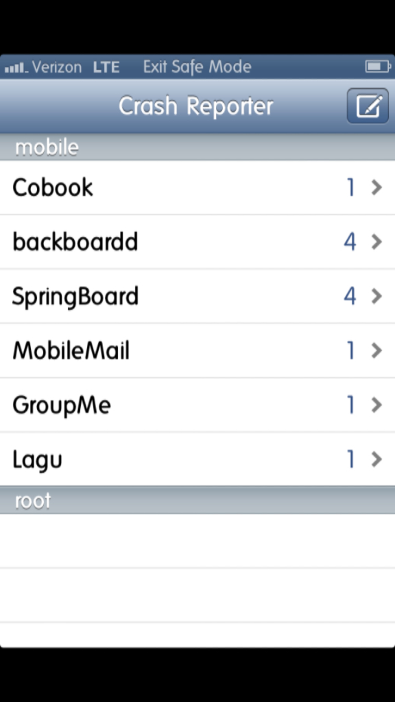

This is happening with mine as well ImageUploadedByTapatalk 21361412792.614705.jpgImageUploadedByTapatalk 21361412821.847211.jpg

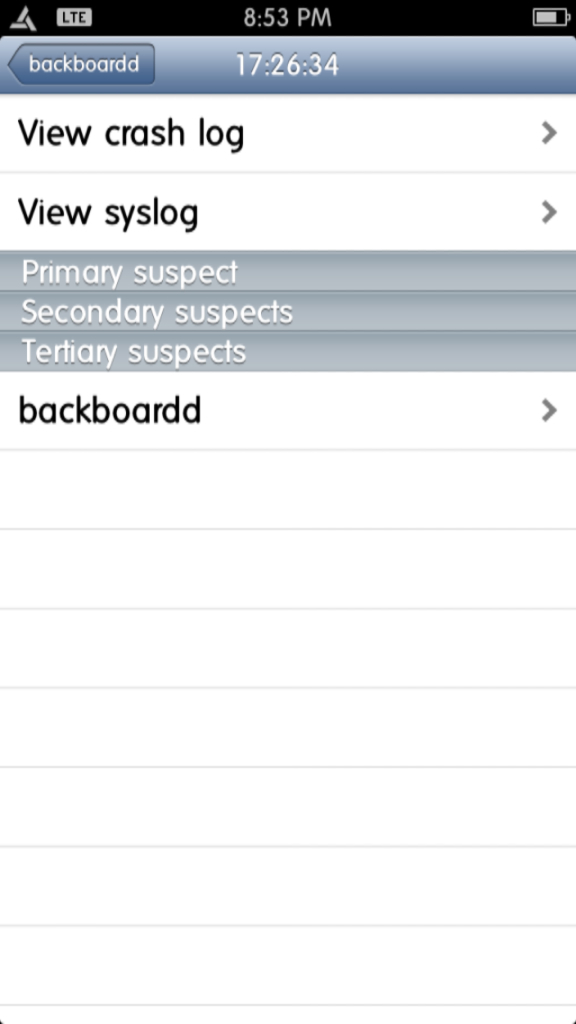

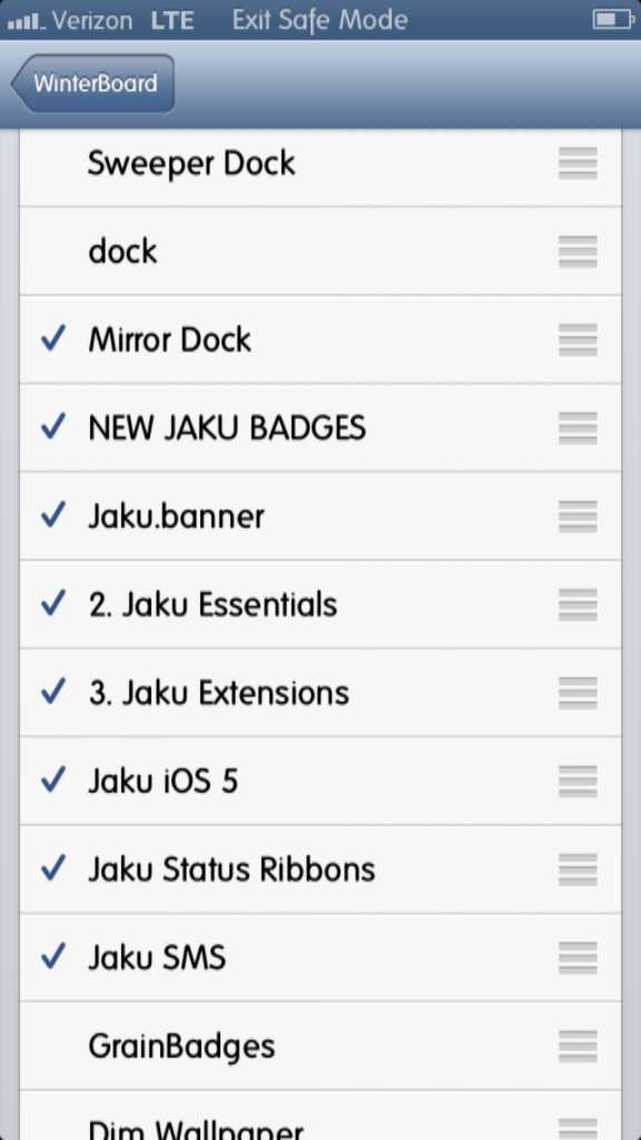

This is my JAKU in Winterboard. I'm getting blackboardd issues with that crash reporter... So I'm thinking uninstalling apps would help but its not. Thought it was sbrotator it wasn't. Then infiniboard but its not. It's crazy...

Oh... And I'm in safe mode because for some reason even tapatalk crashes... Not understanding how this happened. I restored as new.. Upgraded to 6.1.2 (both online) then manually installed each app and tweak..

I'm having the same issue now the last few days as well. The only common line In crash reporter I've found is libsystem_kernel.dylib but searching online hasn't helped.
