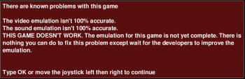

I tested the game noted above by kioshade using 'MAME OS X', Version 0.135 (135.00.00). I also tried Rev. RRS1 Ver.B, Japan but both came up saying they don't work. It says nothing you can do except wait for developers to improve the emulation.
Well, version 0.135 is ancient, so isn't really relevant to the discussion about 0.184.
[doublepost=1493644883][/doublepost]
Fair comment regarding age but you appear to be comparing the version number of one soft to the version number of a different software altogether. Not sure if that works.
