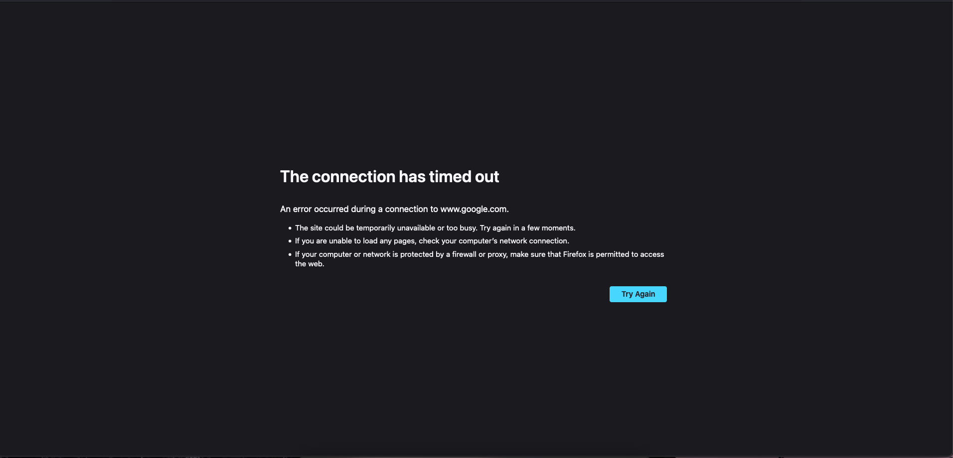

The Internet is working, but now I just can't access Google (google and google drive) properly. Everything else is working as it should.
I get this error:

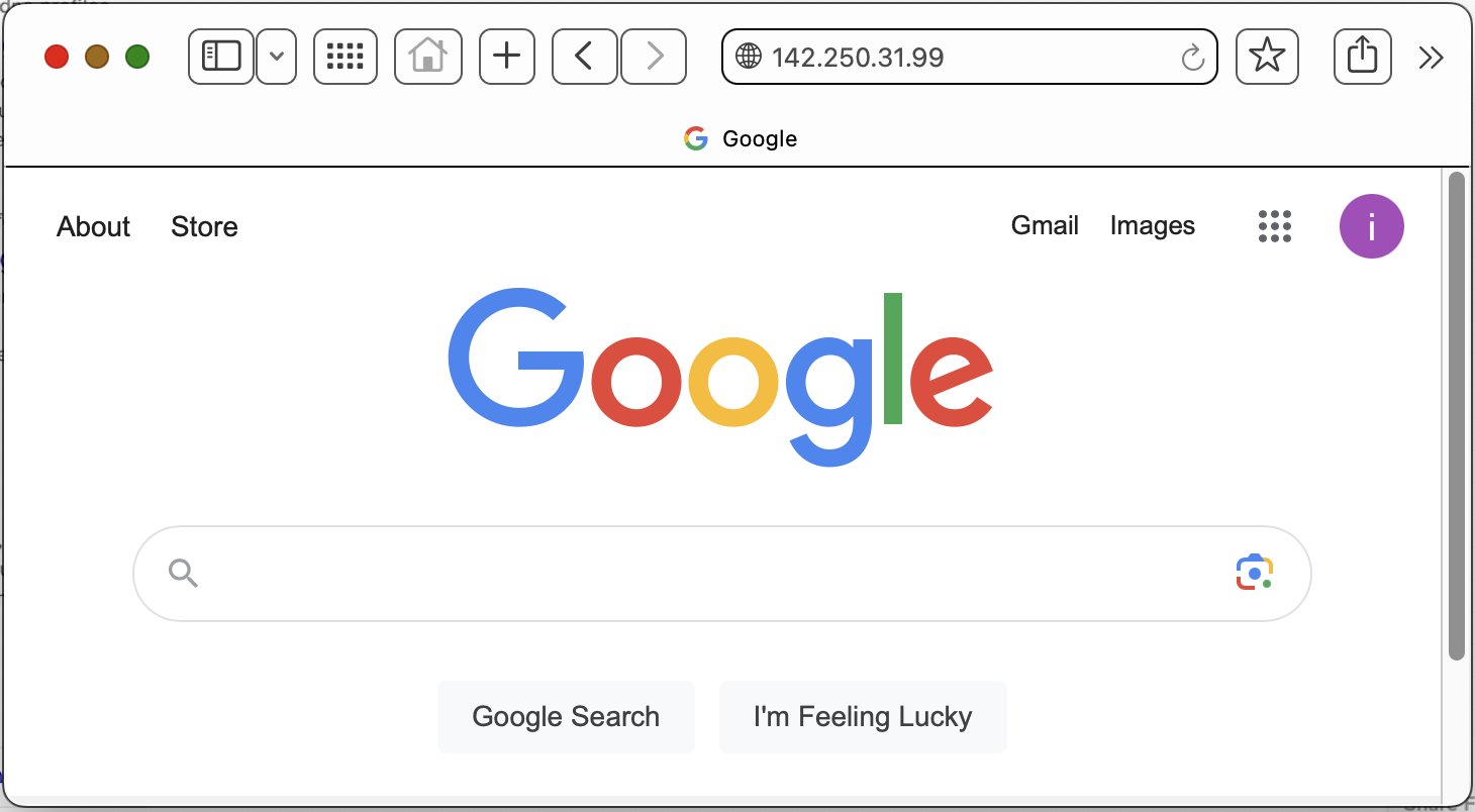

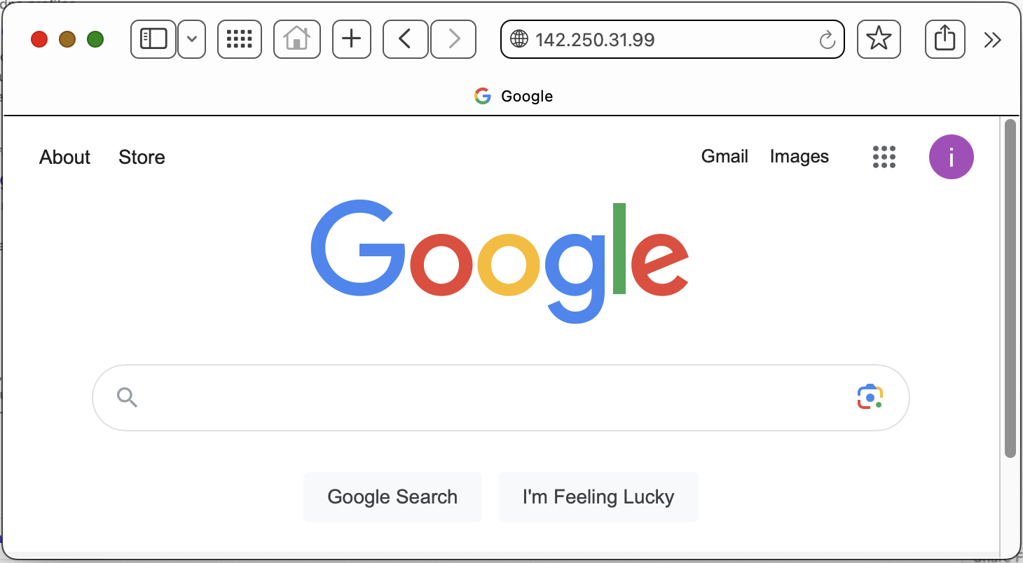

Might be helpful to eliminate DNA as a culprit. Using a device that works, retrieving the actual IP address for a site that's failing, then use the IP in the borked browser's address bar. Here, I just pinged the URL in MacOS Terminal.
This wouldn't support a course of action, per se, but DNS is ordinarily a crucial link between remembering MacRumors exists, and viewing a page. (I know, I know... My ping time is pathetic. Out in horse country, we're lucky to get tMobile 5G extended)

To me this sounds like a DNS problem. With the internet up and accessible outside a browser, but the browser being unable to access a site, it strongly suggests DNS lookup isn't resolving the site IP.
When this happens, in the browser, enter 142.250.191.78 as the destination address (no https or www, just the IP)
This is Google's primary IP address. If when you hit enter, you get Google's home page, then likely you're having a DNS lookup problem on the Mac.
Personally, I'd put Google's DNS server addresses (8.8.8.8 and 8.8.4.4) in the DNS settings in your Network settings pane and see if that resolves the problem more broadly.
