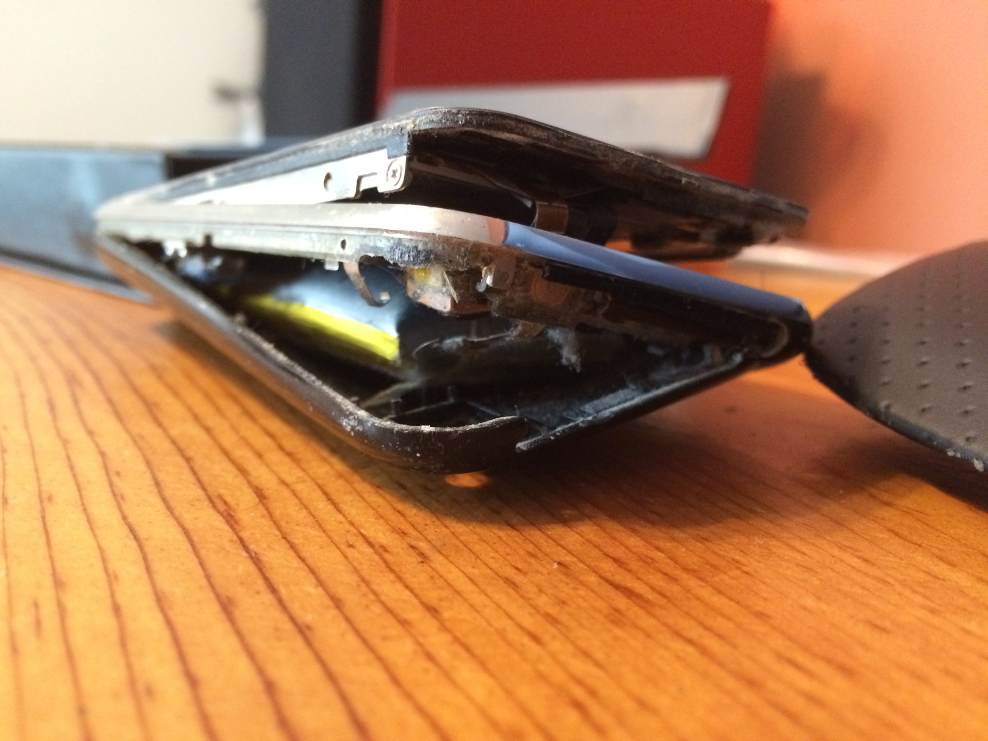

It could damage the battery. When my 3GS was put into mothballs. The battery was in OK shape. I did everything right in discharging to around 50% and turning it off. When I charged it a couple years later. Everything seemed fine. Then within a couple days or weeks. The battery puffed up and destroyed the case. I've also had plenty of instances where it was not an issue. So, with Lithium Batteries it's luck of the draw.

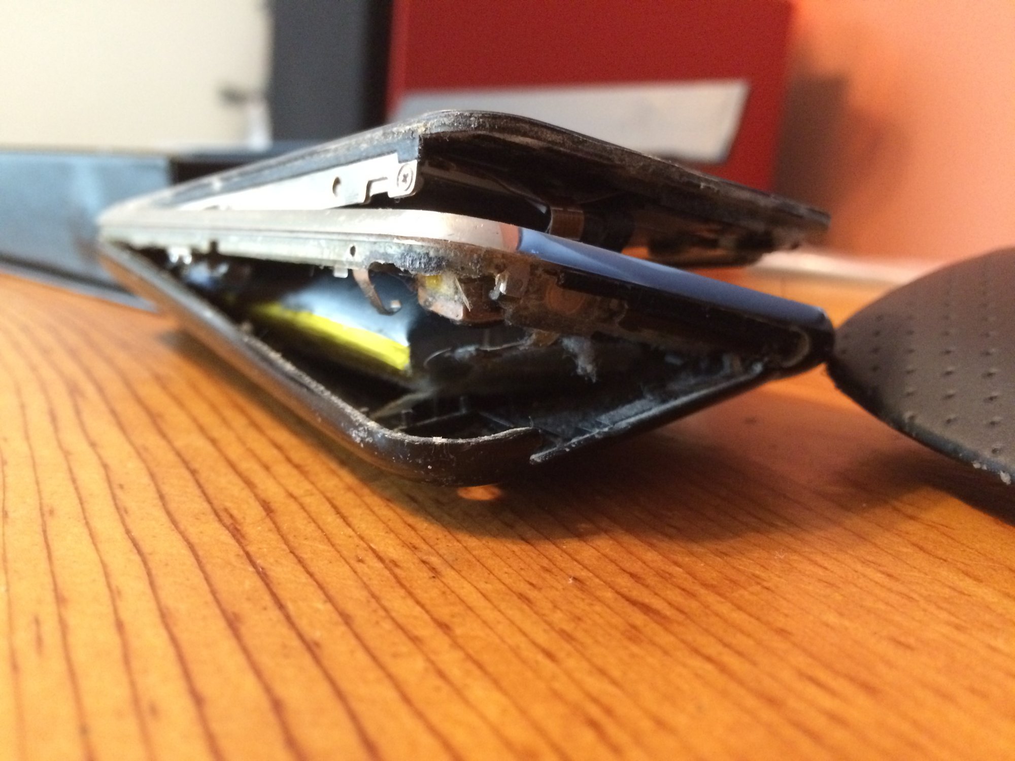

Expanding battery is a safety feature.
Its either a bloated bat or a a fire ball.
