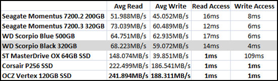

I find it hard to believe that the Blue can match the Black with half the cache and a slower spindle speed, not to mention the higher access times, which are what matter, AFAIK.
http://www.legitreviews.com/article/955/6/
The performance benchmarks also showed that the Scorpio Black 320GB (WD3200BJKT) was faster than the Scorpio Blue 500GB (WD5000BEVT), which is no slouch. The Scorpio black series is faster than the blue series without a doubt.
http://www.legitreviews.com/article/955/9/

If all you want to do is run benchmark software you can see that the Scorpio Black is faster. But in day to day use, when looking at overall issues you may not see it.
