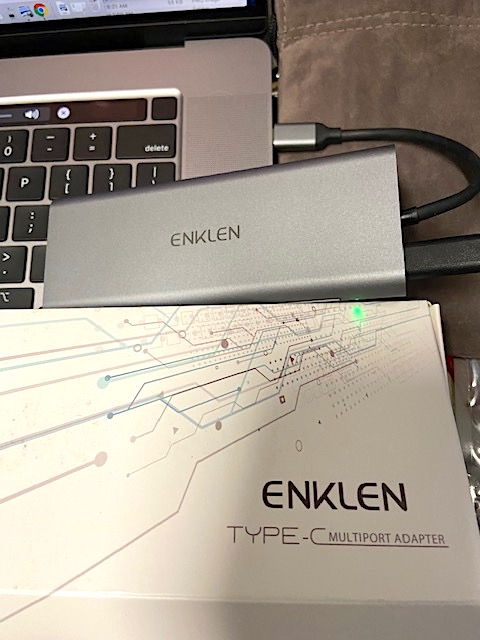

For work, I have a power pass thru multi-port USB-C adapter that works with my work stuff (HDMI, VGA, Ethernet, SD, USB, etc) and my 16" MBP.
Very cool with using up one port and giving me a lot of ports and power pass thru.
ENKLEN EK-TC010:
While this great for non Apple displays, I still use the TB3 to TB2 adapter to connect to my 24" and 27" Apple displays...
