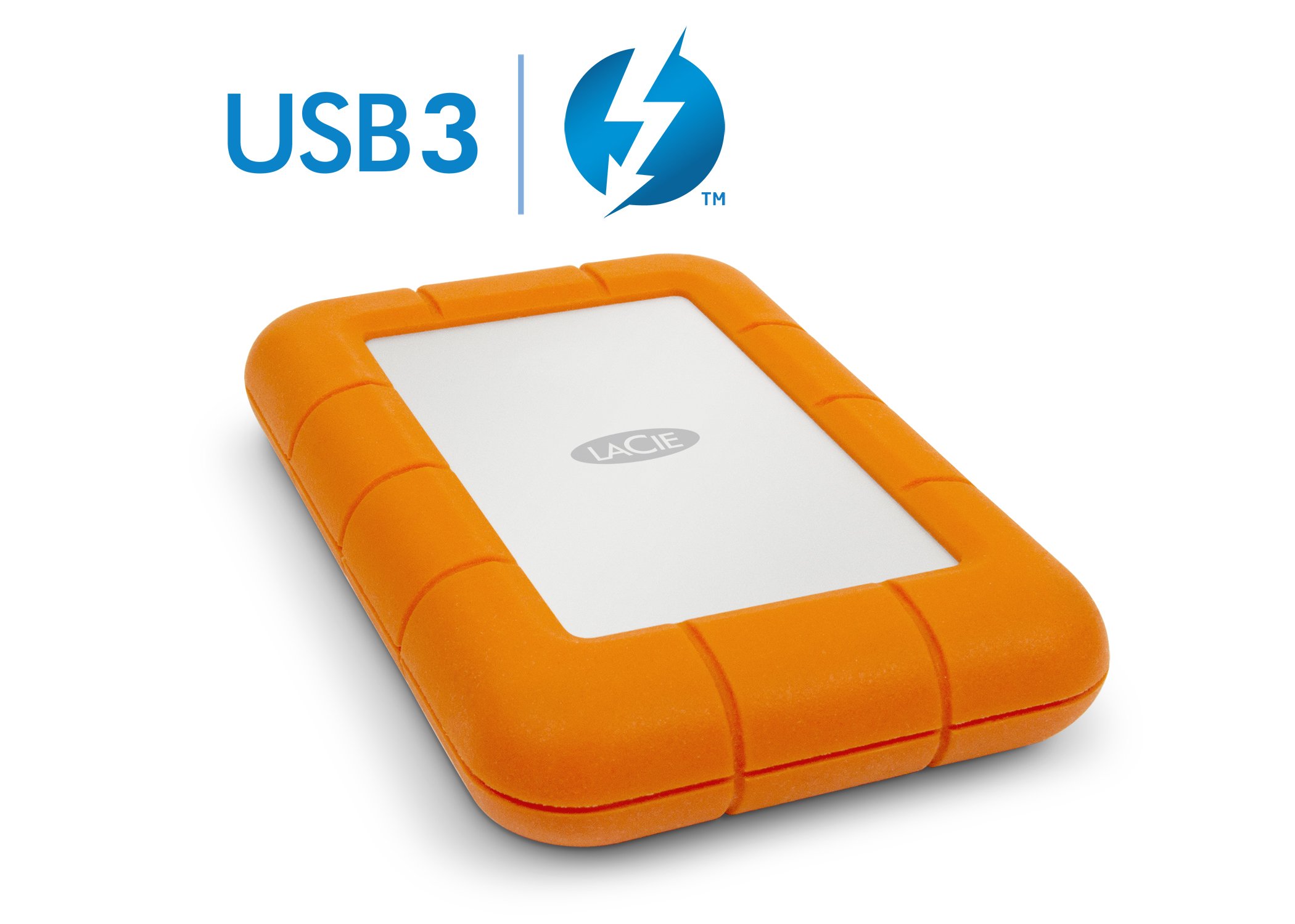

LaCie's Rugged Thunderbolt and USB 3.0 SSD.
Or, if you like it a little fancier, the LaCie Little Big Disk, which houses two SSDs and is up to twice as fast.

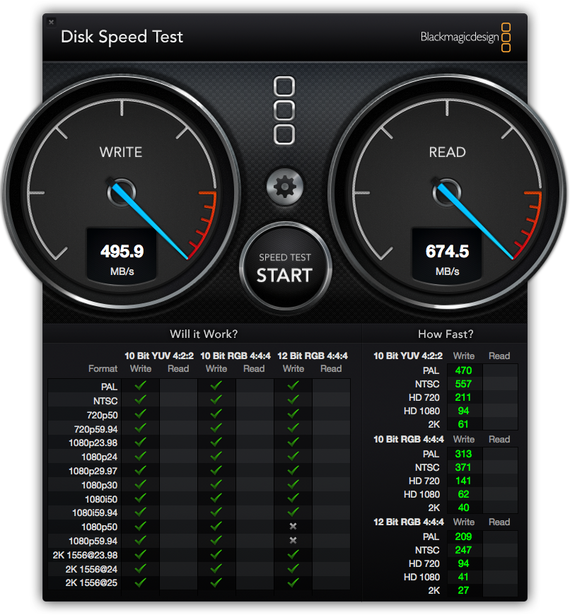

I've got the older HDD version as well as the new 1TB SSD version, and indeed, the SSD version is quite speedy.
Attached is a screenshot of the Blackmagic Speedtest run on the LaCie on an MBP Retina i7 w/internal 512GB SSD, and the LaCie 1TB SSD attached externally to one of the Thunderbolt ports
