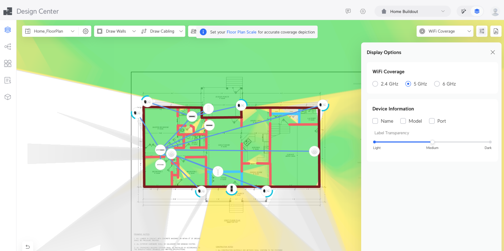

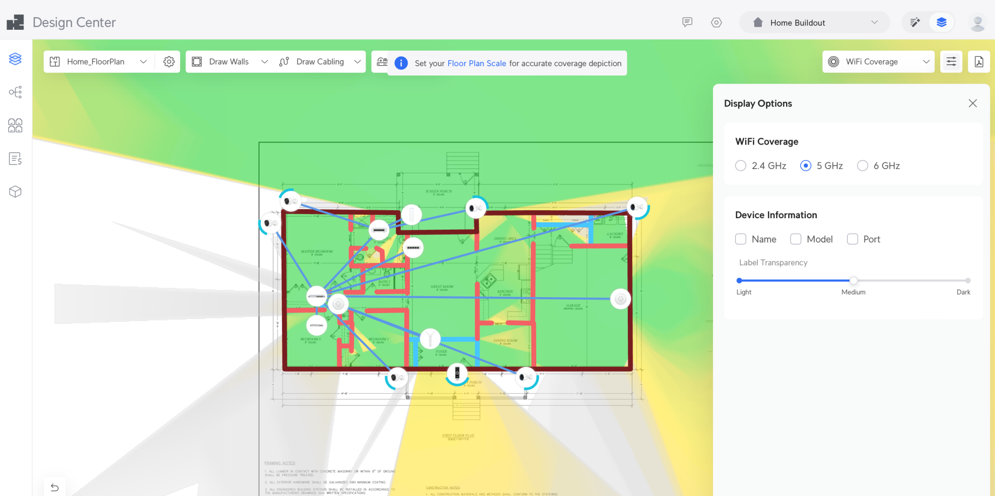

Ubiquiti has a cool design page that allows you to upload your floorplan and overlay walls, then put the actual wifi devices in to see what your coverage could look like.
This is my my floor plan with my UI devices. It allows you to make a shopping cart of what you need to buy as well.
Very cool! Maybe this would be worth it for me - I'd heave to measure my rooms and such, but it's probably worth it.
