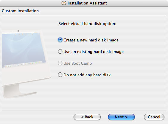

Boot Camp Option greyed out
You know you can use Bootcamp and Parallels from the same Windows installation, right?
I tried setting up parllels to boot from my boot camp partition that but the option is greyed out??
