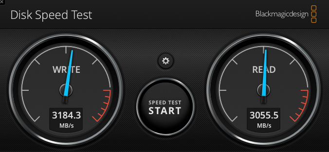

I did this. The speed issue is with the enclosure, not the SSD NVME which are readily available at competitive prices.
With Mac not all fast externals are fast on Mac hardware as it doesn't support some methods. For instance the Samsung T9 does not give claimed speeds. On Macs, the T7 is just as fast. There are some cheaper options, and I'm sure there will be more, but you need USB 4. You also want an enclosure with good heat dispersion, without a fan. I chose OWC's Express 1M2, for $120. https://www.owc.com/solutions/express-1m2 also knowing their Apple experience. You can buy from them with drive pre-installed, but they are expensive. I shopped around on Amazon and bought the WD_BLACK 4TB SN850X NVMe for $266. There were a few other reliable high performing options. It took 5 minutes to put them together. You do want to make sure it's in a fast direct port, and gets priority on startup. This was 6 months ago, so I expect there are more and cheaper options now. It's transparently just as fast as my internal drive, and I've moved a lot of large system default data to this using symbolic links. These are fast in terminal, but there is a free GUI for these as well.
The attached screenshot should speak for itself.

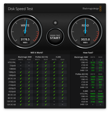

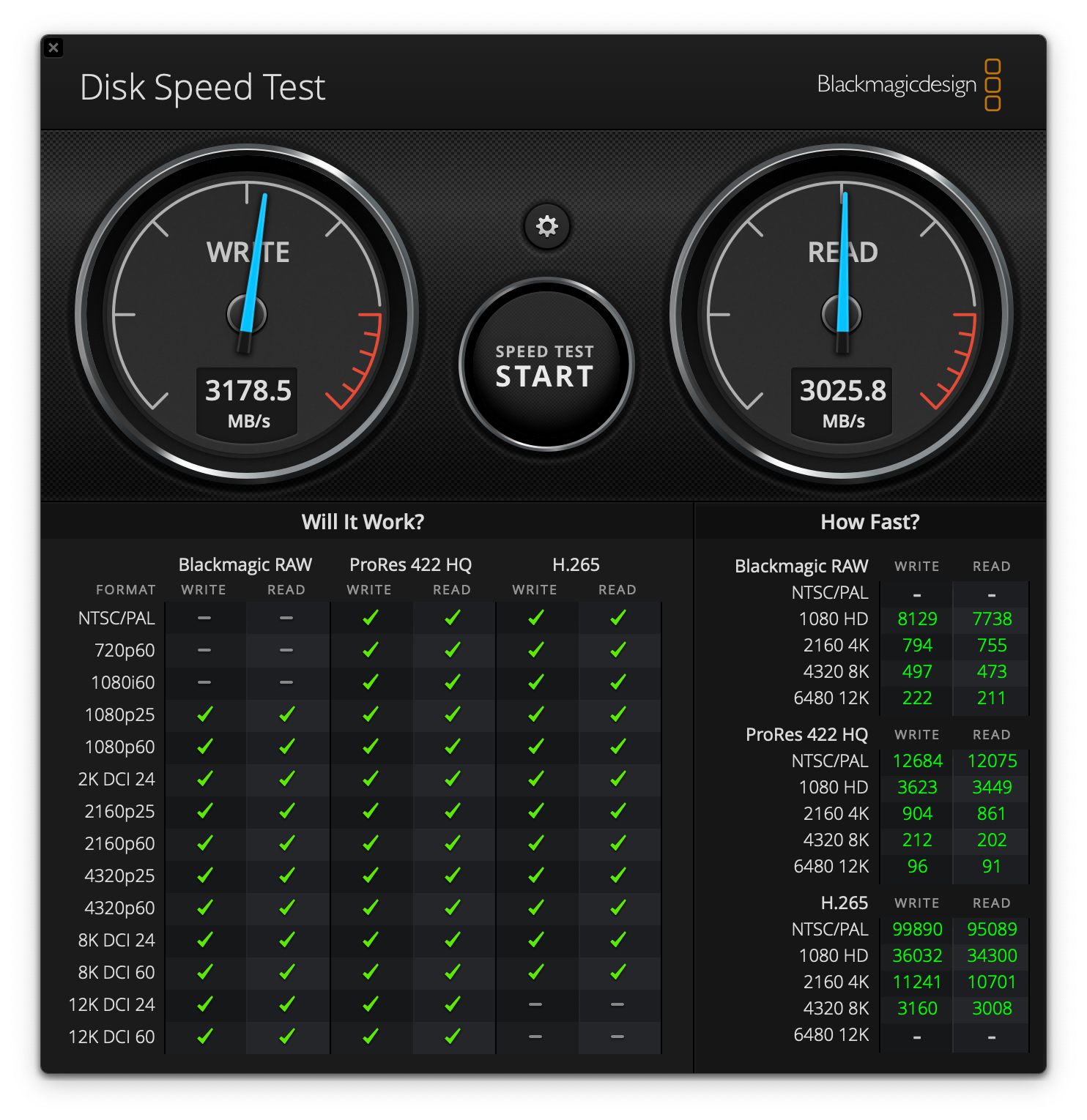

Grab an OWC 1m2 enclosure (USB 4), then put a quality NVMe drive (WD SN850X or Samsung 990 Pro) in it. That will give you a solid external with roughly 3000MB/s to 3200MB/s transfer speeds (read & write). For reference, that means a 6GB file moves from your laptop drive to the external in 2-3 seconds.
OWC 1M2 + 4th WD SN850X (AFPS)

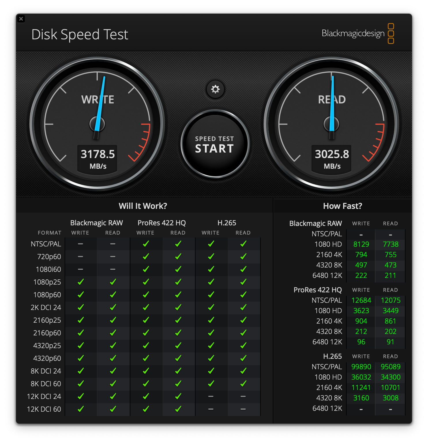

Curious, why not just go with a slower ssd to use in these? You’re only getting half the rated speeds of these drives anyways, seems like a waste of money. Plenty of other quality drives out there that are closer to the speeds you’re getting. A 990 pro or sn850x is overkill in these enclosures
I use mine to work off, routinely transferring very large (photos, videos) files. A drive with DRAM is a must have for my use, plus the SN850X/990Pro generally have superior specs (endurance, IOPS, etc.) compared to the cheaper options. Those are more important features than the absolute speed. I have a SanDisk Extreme Pro (USB 3.2, ~1000MB/S) for the lighter stuff (system and document backups).
If the drive was only used for light duty use (e.g. office work, game storage, or backup purposes), then the cheaper drives might be worth considering. I can't justify them, especially considering the current difference in price from the 4TB SN850X ($279.99) and the other quality options [990 EVO Plus ($249.99), Crucial P3 Plus ($239.99), WD SN500 ($249.99)] is negligible.
Someone mentioned the Samsung T7 as well. I won't, as the OP asked for one that could "keep up with the computer". USB 3.2 drives (SanDisk Extreme, Samsung T7, Crucial X9) cannot do that. They're limited by the 10Gb/s speed of USB 3.2. The SN850X in the 1M2 gives me almost identical performance as the internal 512GB SSD in my MBA, regardless of the type of transfer (small files, up to 300+GB files). A USB4 or TB5 drive will be the only ones capable of doing so.
Also, the OP asked for one that could "keep up with the computer". USB 3.2 drives (SanDisk Extreme, Samsung T7, Crucial X9) cannot do that.
