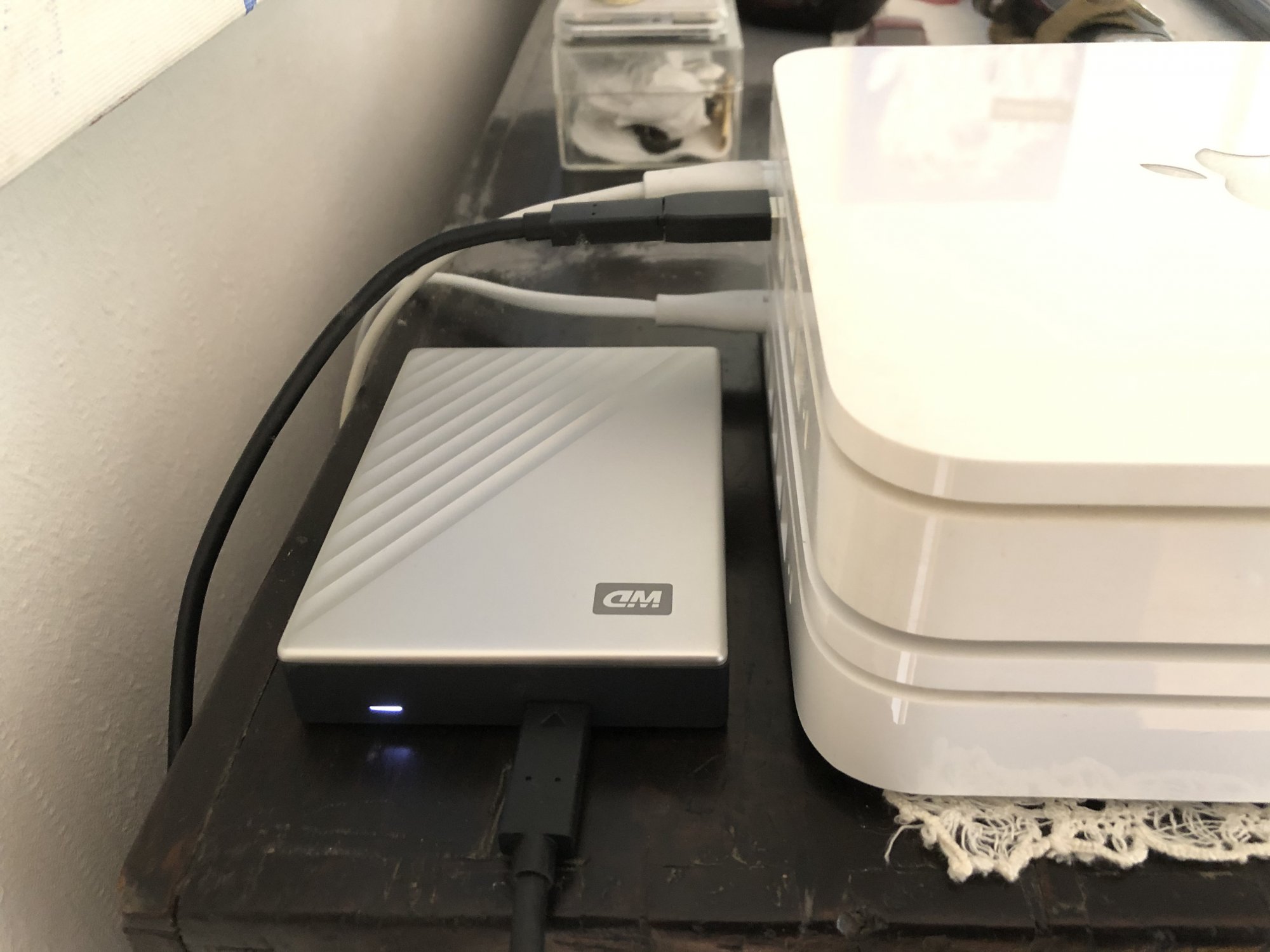

Yes USB powered, I'm actually also using a 4TB WD My Passport as an extra backup disk attached to my old Time Capsule.
