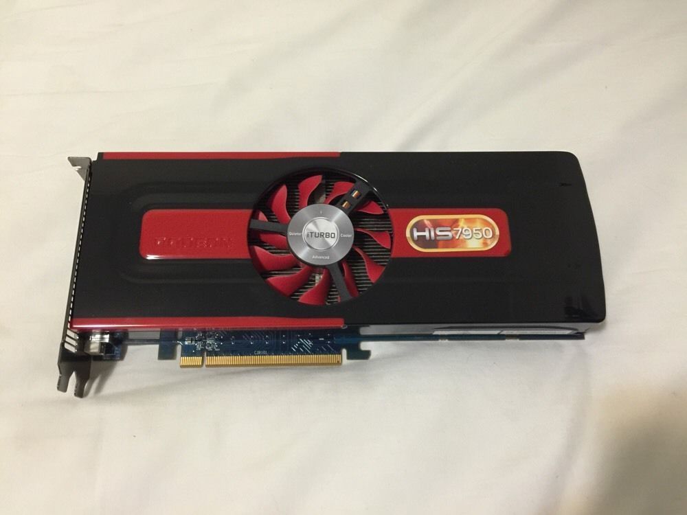

[doublepost=1468674048][/doublepost]I bought an ATI HIS Radeon HD 7950 graphics card for the Mac Pro. 3GB of VideoRAM is certainly an upgrade from the 256MB on the stock cards that I am running. I might be able to sell off one or even both as tested and working spares to off-set the cost of the new card.

There's also a resistor you need to cut/replace on the 7950 to make the card work at PCI 2.0 speed. I'm not knowledgeable about this, but I, too, bought a PC 7960. I sent it off to MacVidCards.com to have it flashed and the resistor attended to. I think it's worth the money to have MVC convert the card for a MP3,1 use.
P.S. You'll have to contact them to see if they still offer the service for the 7950 because it's not on their web site any more.
I'd only bother flashing the bios on the 7950 if I was you. It's incredibly simple to do and, if I'm not mistaken, your card has a dual bios (look for a switch) so that gives you a safety net.
The resistor mod to get the PCI 2.0 speeds requires removing the R17 resistor on the board, although there are mixed reviews if this is even worth doing. Basically you just grab a small screwdriver and pop it off. I have not done this to my card.
For the record I had never flashed a graphics card before in my life and I had zero issues doing it, hence why I think you'd be wasting your money sending it to MVC. Just take the time to read up on what you need to do before going for it.
Plenty of information can be found here: http://forum.netkas.org/index.php/topic,5619.0.html
The user called 'Rominator' in that thread is in fact the guy behind MVC.

GCN-based AMD GPUs (e.g. this HD 7950) are a bad choice for the MacPro3,1 because of a still unfixed power management issue, which will make the performance drop by approx. two thirds.
Since you already bought the graphics card, you'll want to read up here: http://netkas.org/?p=1325
This workaround should still be possible in El Capitan, but you need to disable SIP/rootless to delete the files. You'd most likely have to repeat that after every OS update.

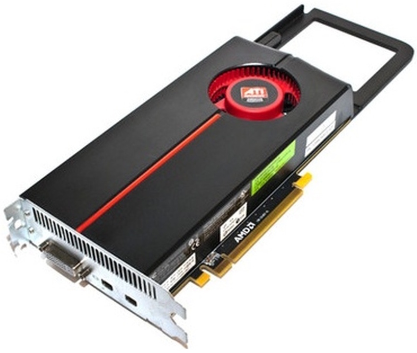

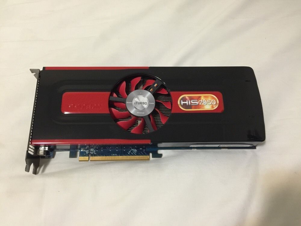

In case the 7950 does not work out well, I have put a bid on a ATI Radeon HD 5770 (1GB) which was taken out of a Mac Pro 5,1. Hopefully it will work properly on the 3,1! My 1080p monitor is only a few months old, so I will probably not bother with a 4K display for at least another 2 or 3 years. Until recently, I was still using a 16:10 1050p display! (You would be surprised what turns up in people's rubbish piles sometimes.)

I put in a bid for one of these. Since it is one originally supplied in a Mac Pro (though a later model) it should work find for me. I've figured that since it will be at least another 2 years before I go to a 4K display, this one will suffice with my 1080p display for the time being.
