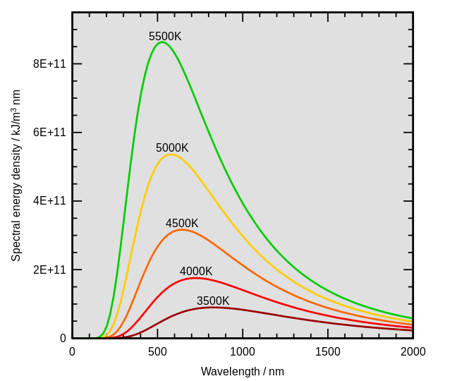

That's not quite correct: there is no such thing as `white' unless you specify a color temperature. Essentially what we perceive as `the most natural white' are the emissions of a black body radiation source such as the sun (even then, the atmosphere absorbs different wave lengths at different rates so that the sun light we see does not follow Planck's black body radiation formula). The sun's surface temperature of 5,500~6000 Kelvin is also the most natural white to us there is.

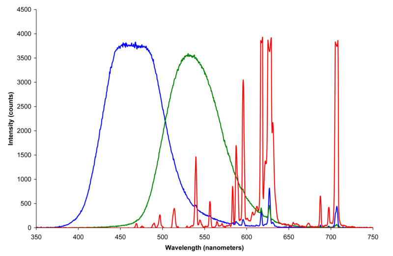

Any light source with a different spectrum, e. g. CRTs, CCFL-backlit displays and LED-backlit displays, that's why the different types of monitors and backlights will display colors slightly differently even after calibration. (Have a look here for a comparison of spectra of different light sources). For CRTs, for instance, blue and green pixels look relatively `smooth' whereas the pixel supplying the reds contains many small peaks at higher wave lengths:

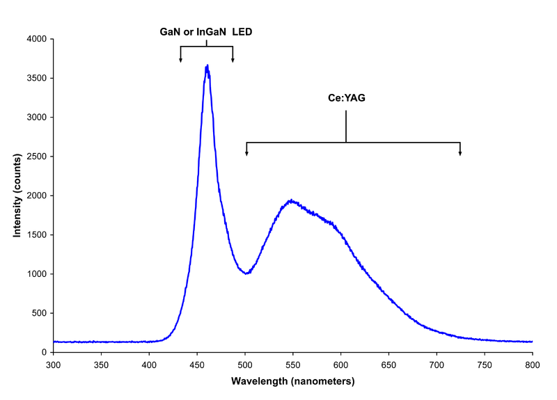

Compare that to a white LED:

This principle is also used in some types white LEDs: they are blue LEDs with a coating which converts some of the blue radiation to larger wave lengths. The other type of `white' LEDs consists of a red, blue and green LED where you can mix the color temperature at will.
