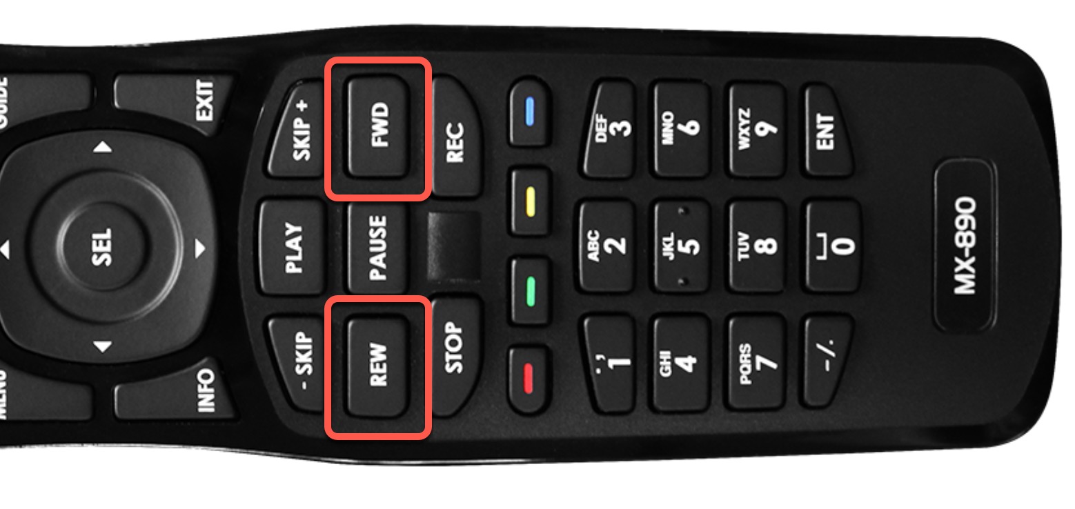

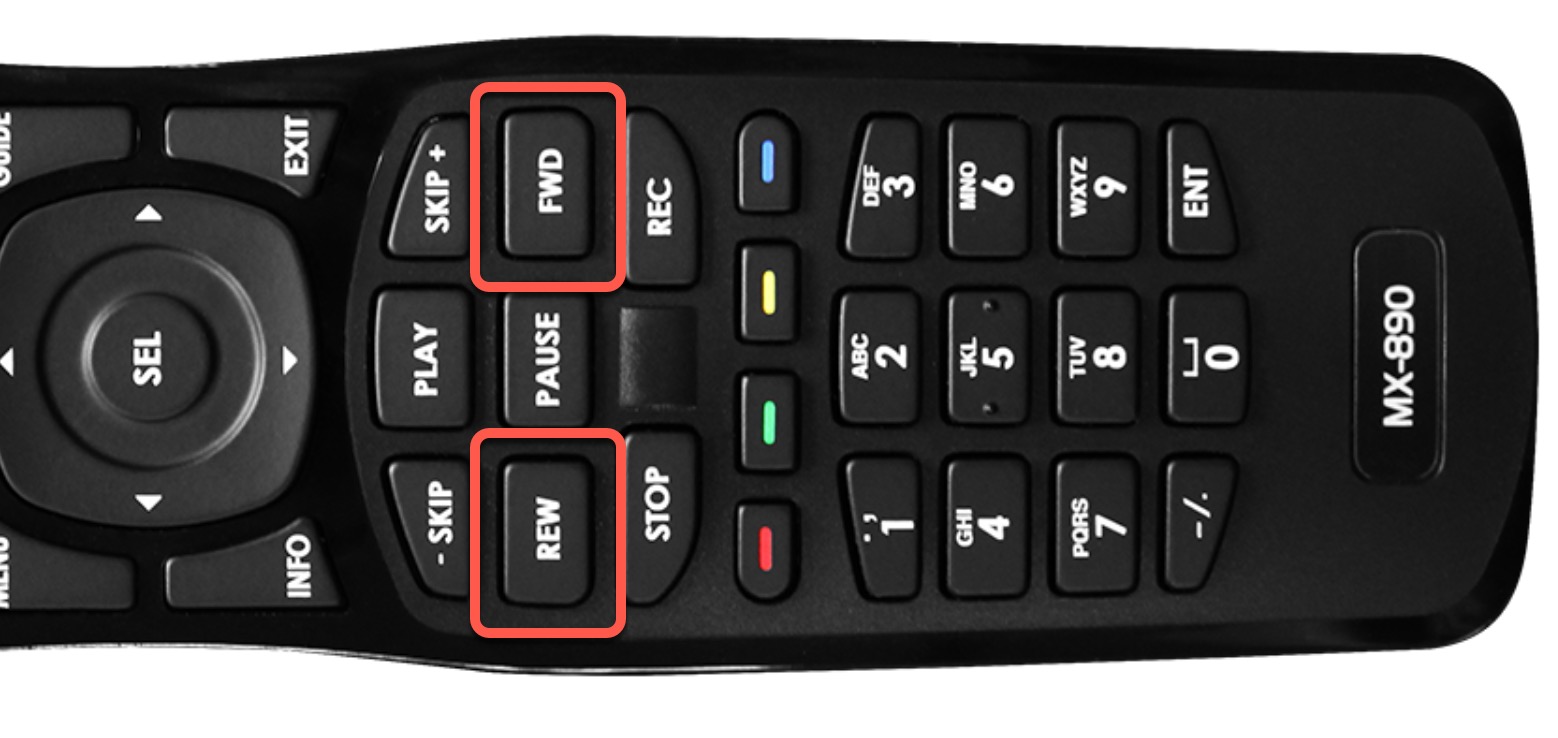

We'd like to get a universal remote to keep everything simple. Has anyone found one that works well with the Apple TV? Someone had recommended the Urc Mx-890, but it doesn't look like you can rewind/ffwd on the Apple TV with it.

And you most certainly CAN rewind and fast forward on the URC MX-890. If it has the dedicated buttons, you can make AppleTV use them (either by learning them on AppleTV or programming them on MX-890)...
