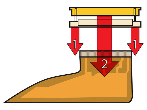

It's very clear. If you were using iFixit, how could you miss this?
1My2qQPgM1eSDiDW.medium
Step 5
  • This is a diagram of the trackpad ribbon clamp connector you will disconnect in the next step.
  • 1) With your fingernails, grasp the locking bar on either side slide it a small amount (about 1/16" or 2 mm) towards the battery.
  • 2) After disengaging the locking bar, slide the cable out of the connector.
Full instructions to remove the top case.
If you have ripped out the trackpad cable then it's possible you need an entirely new cable. You may need even a new top case if you have damaged the hardware around where the cable is secured.
Top cases run about $80-150 on eBay. Not sure how much a new trackpad cable is.
If it's merely a matter of fitting the cable back in to the connector you have to make sure those little tabs are pulled out. It's a ZIF socket. Push the cable back in then push the tabs back in. Essentially the reverse of the step above.
