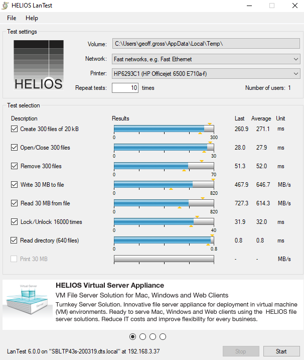

edit - nevermind, i realized this was a test of my internal drive. cant run this for real until I have a network drive to select!
FWIW, Helios test results here (on my work PC, recording will be done on a mac):
Glad to see you are making progress. Once you get your network drive mounted and selected, you can compare your network performance to local drive.
And yes, at the risk of over-simplifying, one can see that as NAS boxes go up in CPU performance, so does transfer speeds (until the network max is achieved, and thus becomes the ceiling or bottleneck). It can be tricky figuring out where the bottleneck is with slow network performance: server, server disk, cabling, switching, routing, termination, or destination NIC or storage.
If you dig through Synology (or other brands) specs, one can see the max transfer speeds go up with CPU performance until saturation is reached. Pretty clear CPU matters, at least at the lower end of the product line. The harder part is to know how much is "enough" for a single, high-performance connection. Often the bottleneck is a bunch of connections, like in a multi-user space.
LAN test will at least show the overall performance of your network to a share vs. local. Might be worth comparing USB to internal to see if there are any obvious limitations too.
