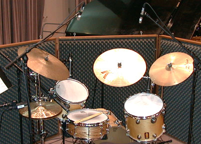

Also, if you can afford them, get this drum mic kit. You get a kick mic, and four clip-on mics, one for snare, three for toms. Then get these as 'overheads' and two mic stands to go with them. Basically, you place them over the top of the drum kit like this:

The main thing with miking a kit is to get the space you want. If you are making a stereo recording I would suggest 4 channels is the minimum
1 - Kick
2 - Snare
3/4 - Overheads
If you have the money I would then also then go for the hi-hat, then start micing up the toms - but only do this if you can mic all of them.
If you are mono recording however you may be able to get away with 3 by removing one of the overheads - but this will depend on how your drummer plays, if like most drummers they like to spread out you may still want to go with the two overheads.
