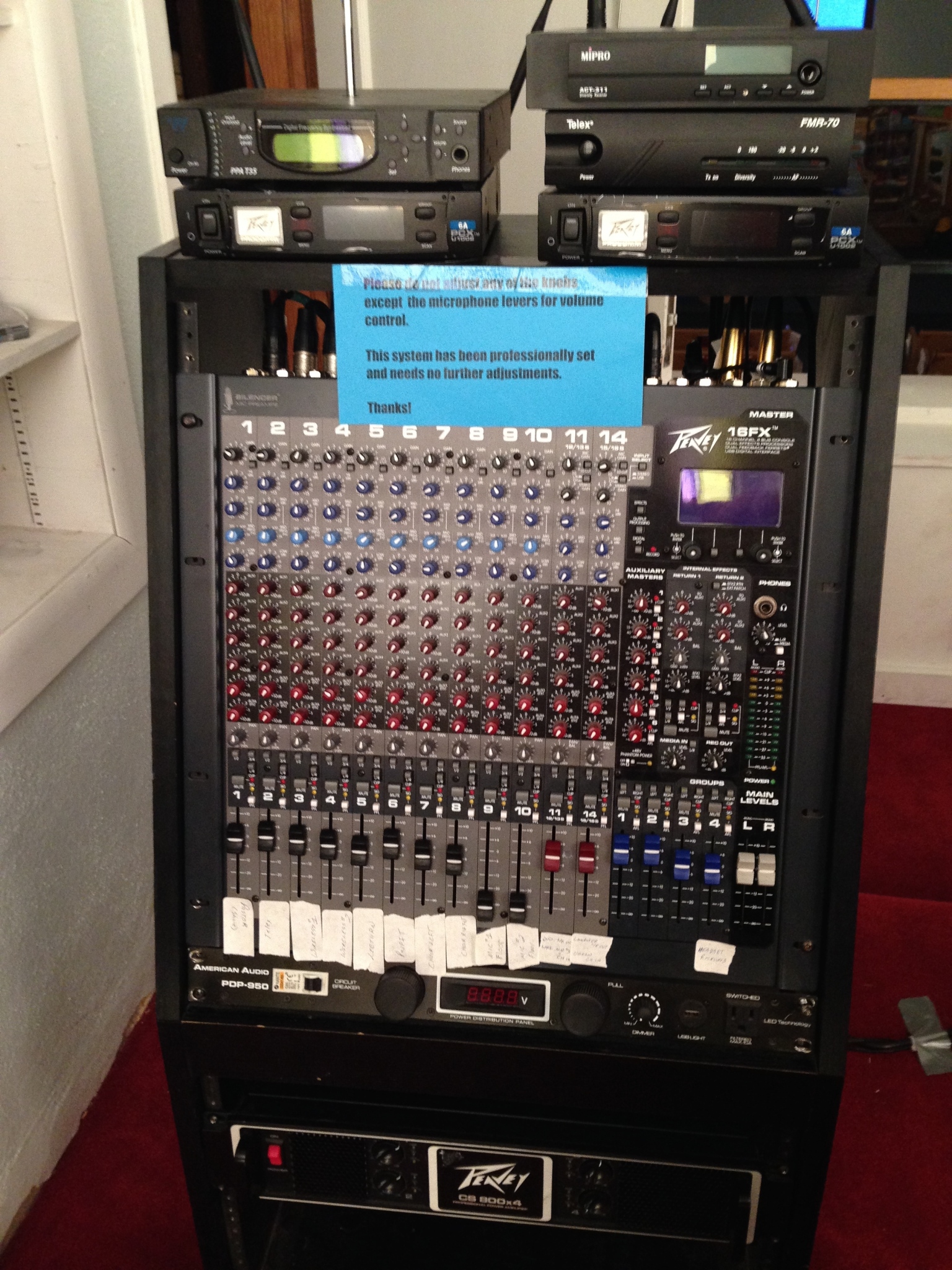

The equipment in question:
Peavey 16FX mixer feeding through a Peavy amp (and feeding into a few self-powered speakers / monitors) You can see the various wireless mic receivers and transceivers stacked on top.
Mic is a MiPro Act 30T
So again, we're talking about live audio; not any sort of studio recording setting. That's why the mixer needs to be there. I appreciate the help! I'll look into what you suggested!

Eureka! Maybe.
While looking at the system I happened to notice that, whadya know, it has a USB connection! And with that USB connection, it will send the audio direct to the PC! Windows immediately recognizes it as a "peavey mixer"
That's a "free" (Well, the mixer was $850 but we already have it) option I can at least use for right now while I continue to explore further options. But, in investigating it, it seems to do extremely well. Which a quick run through audacities 'noise removal' filter it sounds, to my ears, pretty darn good. And I believe the little bit of humming I got would be there either way as it comes through the speakers anyway. It's very, very slights and almost undetectable through the speakers but is a little easier to hear on the PC, but audacity makes quick work of it. Certainly good enough to use in the meantime, and requires no equipment. Plus, it's less equipment and less cables, and that's a good thing right?
There seems to be a lot of features on the mixer side through it's little LCD screen for the USB features. Including recording audio direct to a USB drive and of course taking audio both ways. I noticed an improvement in audio quality running sound out through USB than through the previous RCA. As an added bonus, the volume and mixer controls for the PC are still the same, as it was plugged into the connection that corresponded with the USB port anyway (there's a USB / Line selector switch).

That sounds like the smartest way to go then. At least until/if we start live streaming. And that may be what I do. But for now I'm going to use the mixers built in USB while I can until I research further what I want to do.
